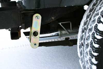

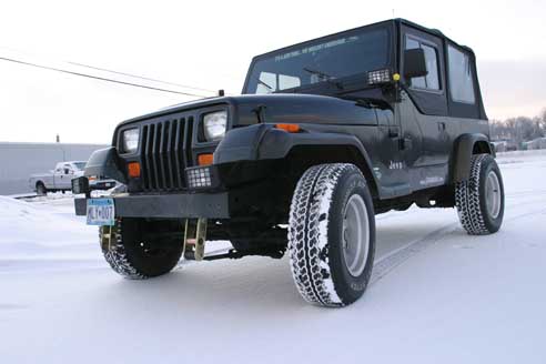

here is the finished product (for Now) with exhuast that i put on last weekend

Looks good. Hows your steering? We put 1 1/4 lift shackles on my gals yj for about a week. Took em off because driving was a crap shoot every time.

if you shim your front axle.. the steering will not suffer much or at all
