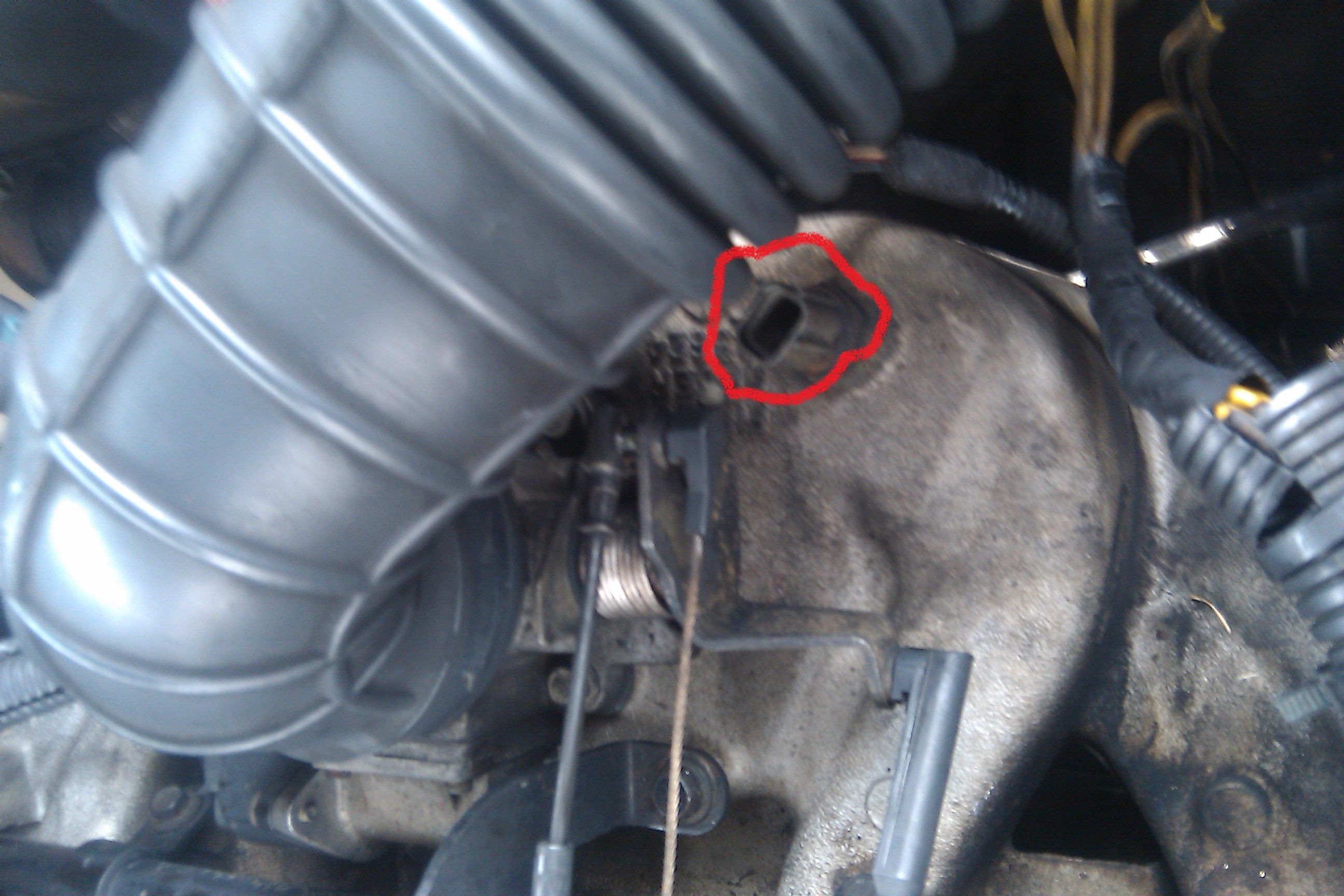

so here's a pic from the top of my intake. Is the circled item where the CPS attaches on top? please help me out!

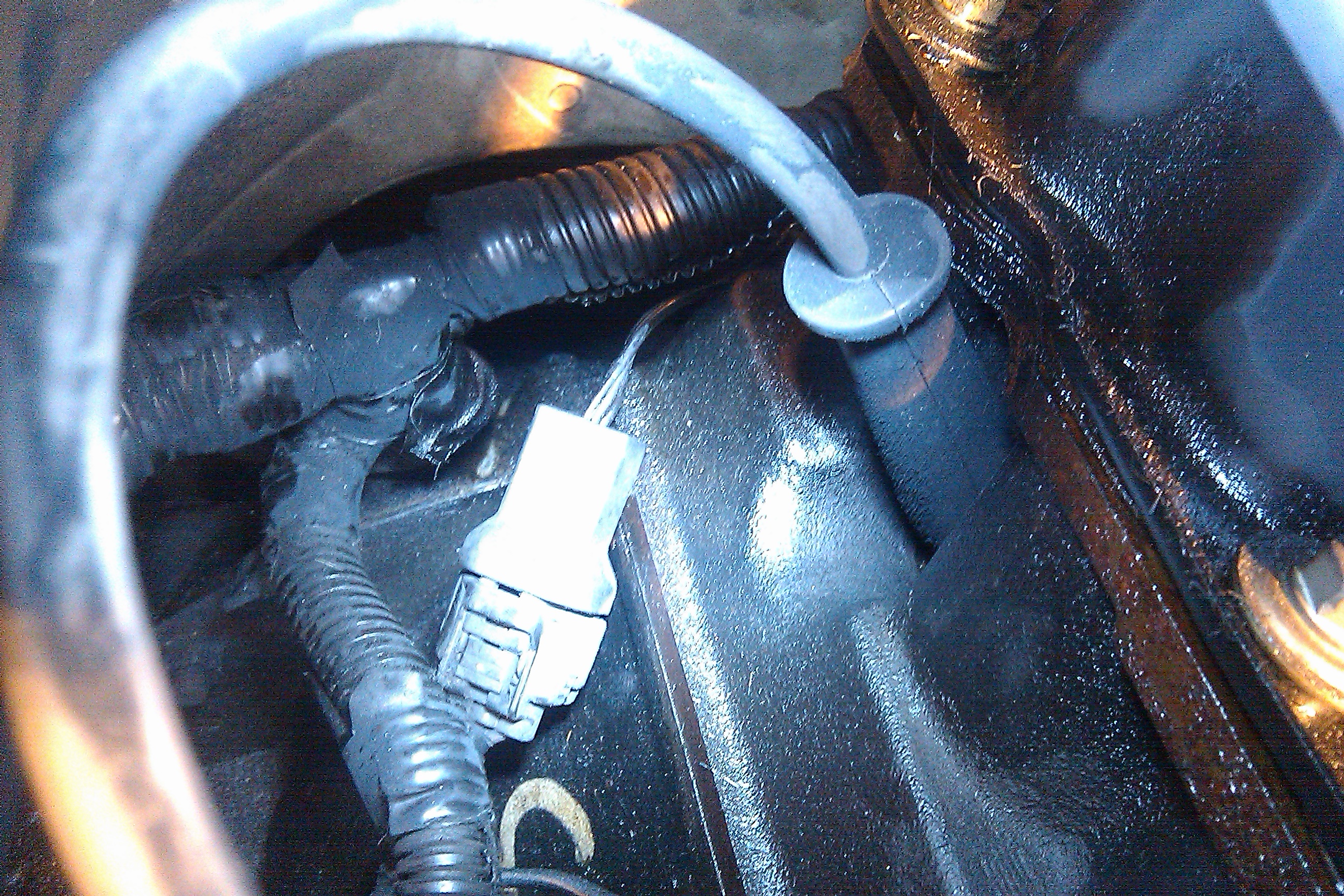

so crawled under the car couldnt see anything loose from the bell housing. felt around up top and couldnt find anything. the circled item is still a mystery because i cant find anything loose that would fit it either. my chilton guide is useless with diagrams for my truck..really close to doing the "beat it til it works approach! really bummed, i wanted to turn her over and hear what she sounds like with the new exhaust manifold.

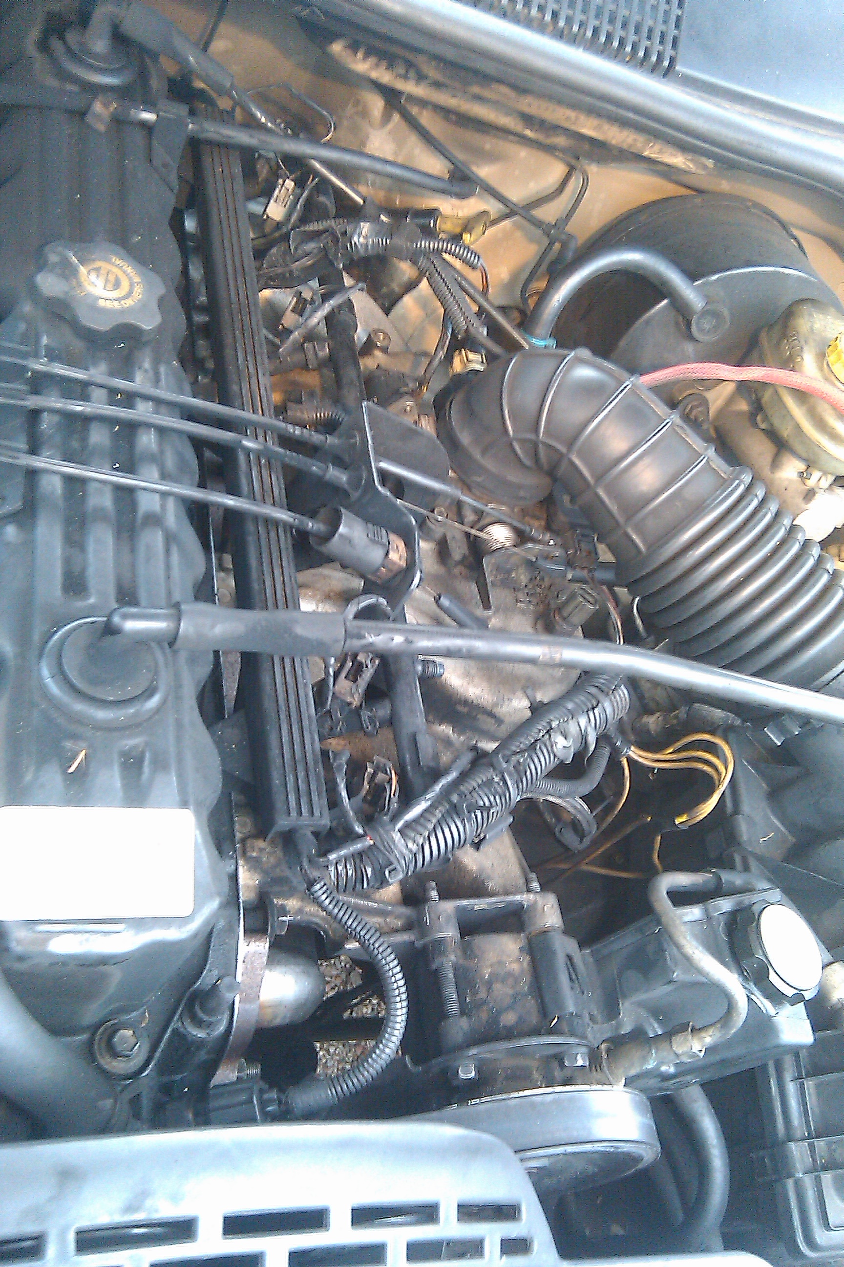

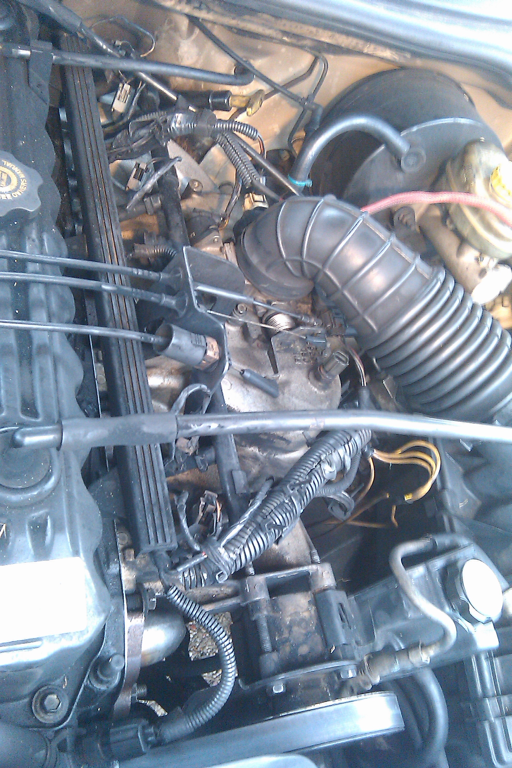

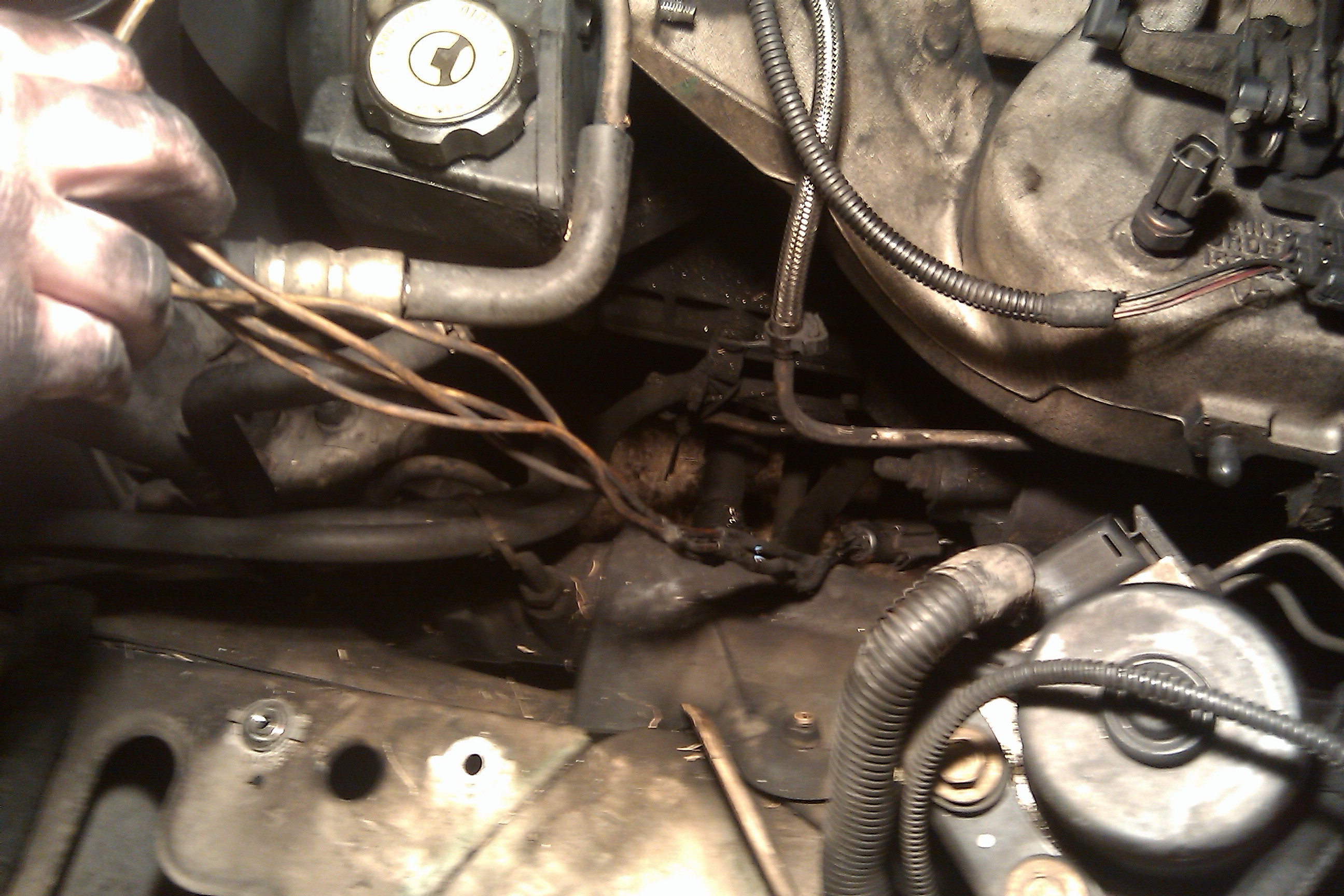

So Ive hit a brick wall. I've attached some photos. The third one is the sensor from the bell housing, but on the passenger side of the engine. any ideas?
