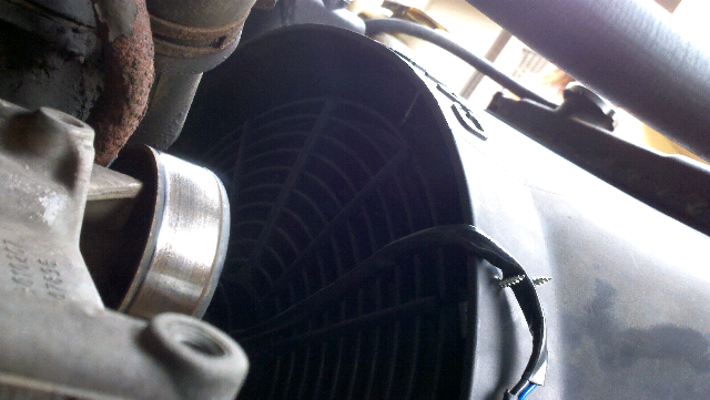

Just added new fan
Cool, what kind of fan did you get? and how is it working for you, what difference do you feel performance or other wise?
No notice of real power increase that can b felt that I know of. But I have noticed that the motor runs 20 to 30 degrees cooler than b4. I got a psc fan and switched on the acc so It comes on with the key. Used the original fan shroud mounted it with 90 dagree angle brackets. All in all it took me about 3hrs not too bad considering I was on the phone and bs'n with some friends.
