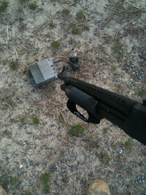

She is ALIVE!!!! I must have had a momentary lapse of judgment and reasonable thinking. You guys, don't be afraid to yell "hey dumb dumb!! Whatcha thinkin?". I must have had the whole hei thing in my head. I did not bypass the ignition, just the emissions. DUH!?!? New ICM and were off to time and tune again. Thanks guys for the patience and understanding as I am new to turnin a wrench. I'll be darned if I didn't learn a WHOLE lot about my CJ this week.
I think y'all know what happens next....ha ha ha ha
