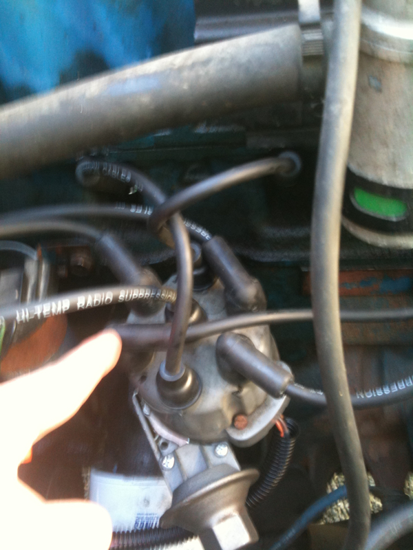

This is a request for knowledge, if you were times 180*out, how would you know? What are the signs and symptoms. I am timed right now at 10*btdc. It seems as though thorough this process with the ignition box failing, every time I remove or swap distributors, the vacuum keeps having to be turned clockwise more and more. My #1 and #6 wires are stretched to the limit. Here is a pic. Don't get me wrong she runs ok, still spudders upon initial throttle but my mixture is not right yet. My finger is on #1wire

number 1 wire is supposed to be were the electronic wire with the black plastic is at. the vacuum canister should be over where that black wire from the ecu comes into the body of hte distributor in your picture.
it means when you dropped your distributor in, it wasn;t rotated all the way. what that means is that as long as you know where number 1 is, you are ok, but if a shop does work for you and it requires changing the cap and wires, they are not going to be happy when they try and star your jeep since the time will be off.

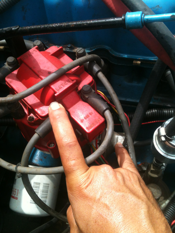

Here's a picture of mine. Pointing to number one. Pinky pointing to advance canister. I think you should reset it at tdc

As long as I got you guys to fall back on, this puppy ain't never seeing the inside of a shop. (unless I roll it)
the only issue you will have with the way your distributor is clocked right now, is that if your motor mount ever shears the bolts (like my wife's wrangler did, twice) on the passenger side, is the motor will drop on the oil filter and maybe break your distributor off since the vacuum canister is right above the mount.
(your mount is right there, right? my 4.2 has it right there and so do the 4.0s)
when i swapped my distributor last week or when ever it was, mine came out pointing too far over like that and i kept having flash backs of the motor mount bolts shearing on the road but this time the distributor being torn up since the canister was right there. i pulled it and reset it away from the mount
Oh wow, I screwed up. I said put the dist in a roughly 6:30 position ( assuming looking at it from the front of engine.) wrong!!! I was looking at the pic in my manual wrong, 808's pic is the correct position for #1. everything was turned sideways in my manual and I was looking at it wrong. His appears to be perfect.
