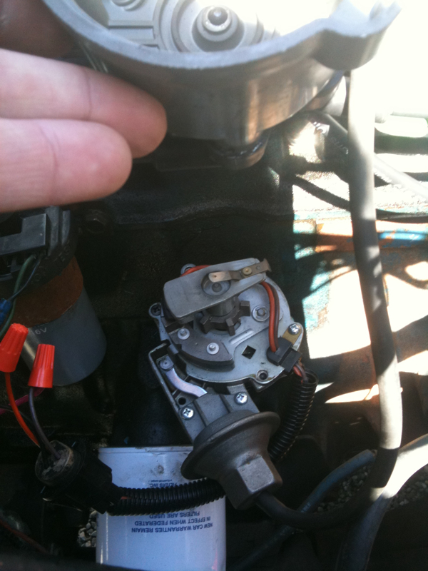

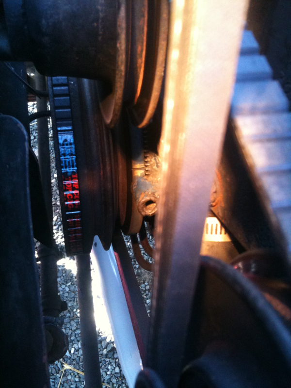

Still waiting on fed ex but.... She should be ready. What do you think? Pic one should be TDC. Pic 2 is where my rotor is lined up. Keep in mind, I was out of whack when I started. COME ON FED EX!!!

Rotor looks correct. Your vacuum advance should be around 3:00
