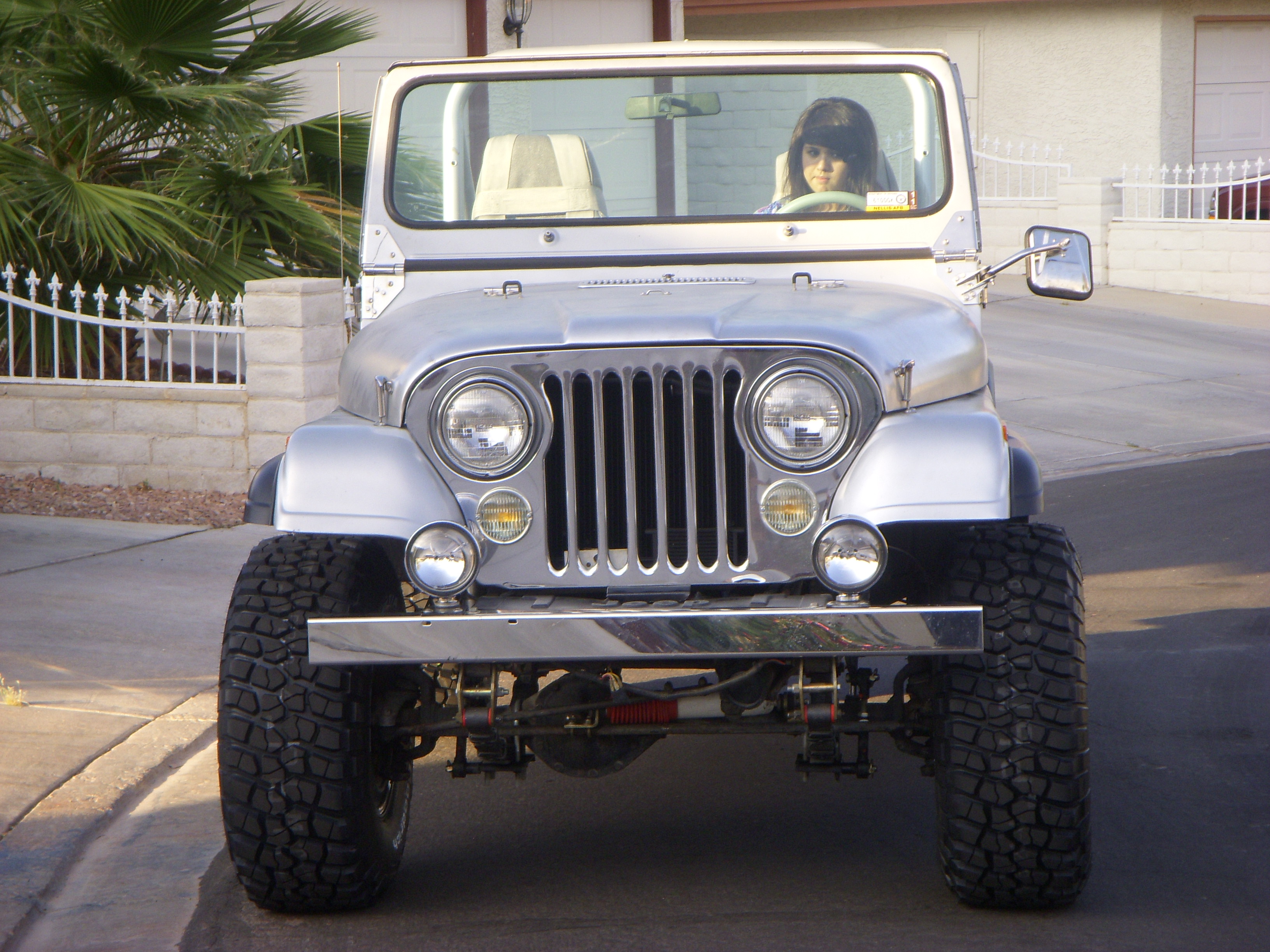

Ok I just bought a 87 CJ7 for mainly trailers and dunes. It looked very very clean with nice upgrades.
1992 Chevy V-6 High output CPI 4.3 C.I. engine– Central Port Injection with internal balance shaft. Painless engine wiring kit. Electric cooling fans (2) with thermostat control. New T-5 World Class Transmission & Rebuilt transfer case. Front 4.10 diff Detroit True Track locker. Rear 4:10 diff with ARB locker and on-board compressor.Pro-comp leafs, 2" body lift, front Fox shocks and rear Bilstein shocks. Heavy duty Spicer front axels and joints. Rear axles switched out to one piece axles Heavy duty driveshaft with CV Joints. I replaced the 15x7 rims with 15x10's. I also put 12.5 35's on it. It had narrow 31's.
Here comes the problem. My father in law was behind me and noticed that the rear tire on the passenger side sticks out farther from the body than the drivers side. Yep I checked it and it is about 1.5 inches farther from the frame than the drivers side. And the same amount from the fender flares.
I changed out the 3/8" leaf spring centering pin. As the old ones needed it. No Luck. It might be even worse now?????

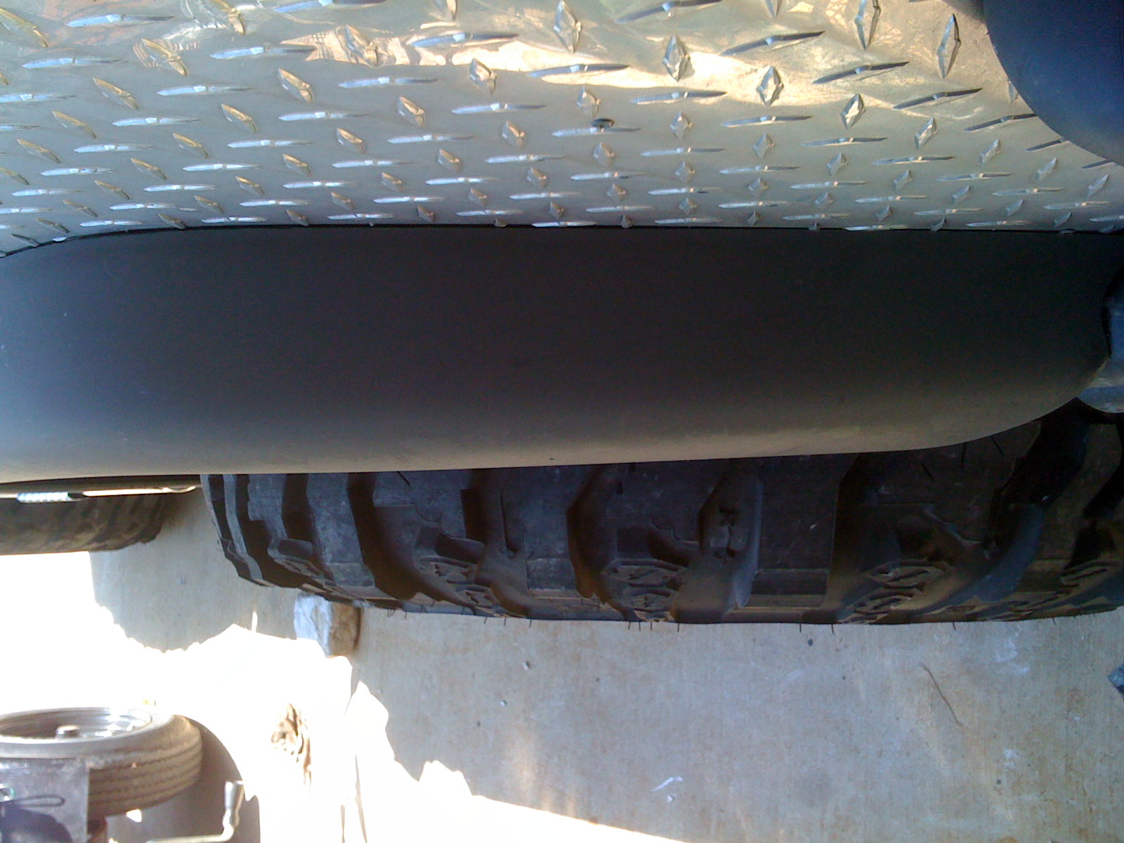

Taking a straight edge I lined up the rear to the front. The passenger side rear is out about 1-3/4" from the front. The drivers side rear is around 1-3/4" inside the front tire. The drivers side tire has about 2.5" between it and the flare. The passenger side has around 4".
It rides fine. Well at least I thought it did before this was pointed out to me. Now I think it pulls and I can't help but notice the wheels sticking out or in depending on the side.

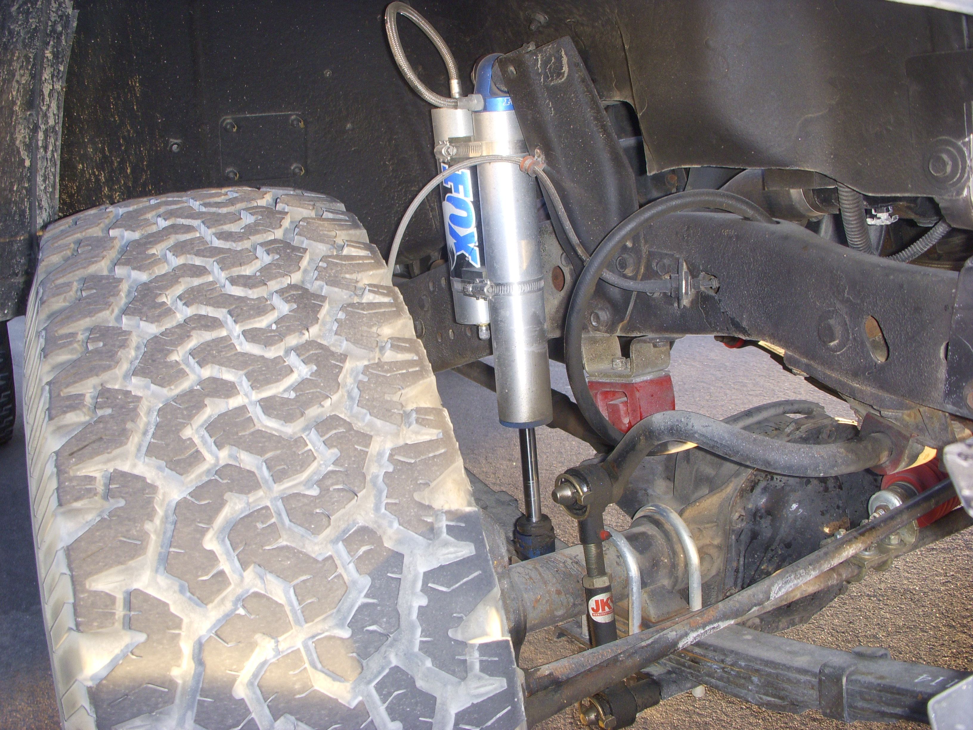

Here are some pictures.
Driver rear
Passenger front.
Drivers rear.
Passenger rear.
Thanks in Advance.

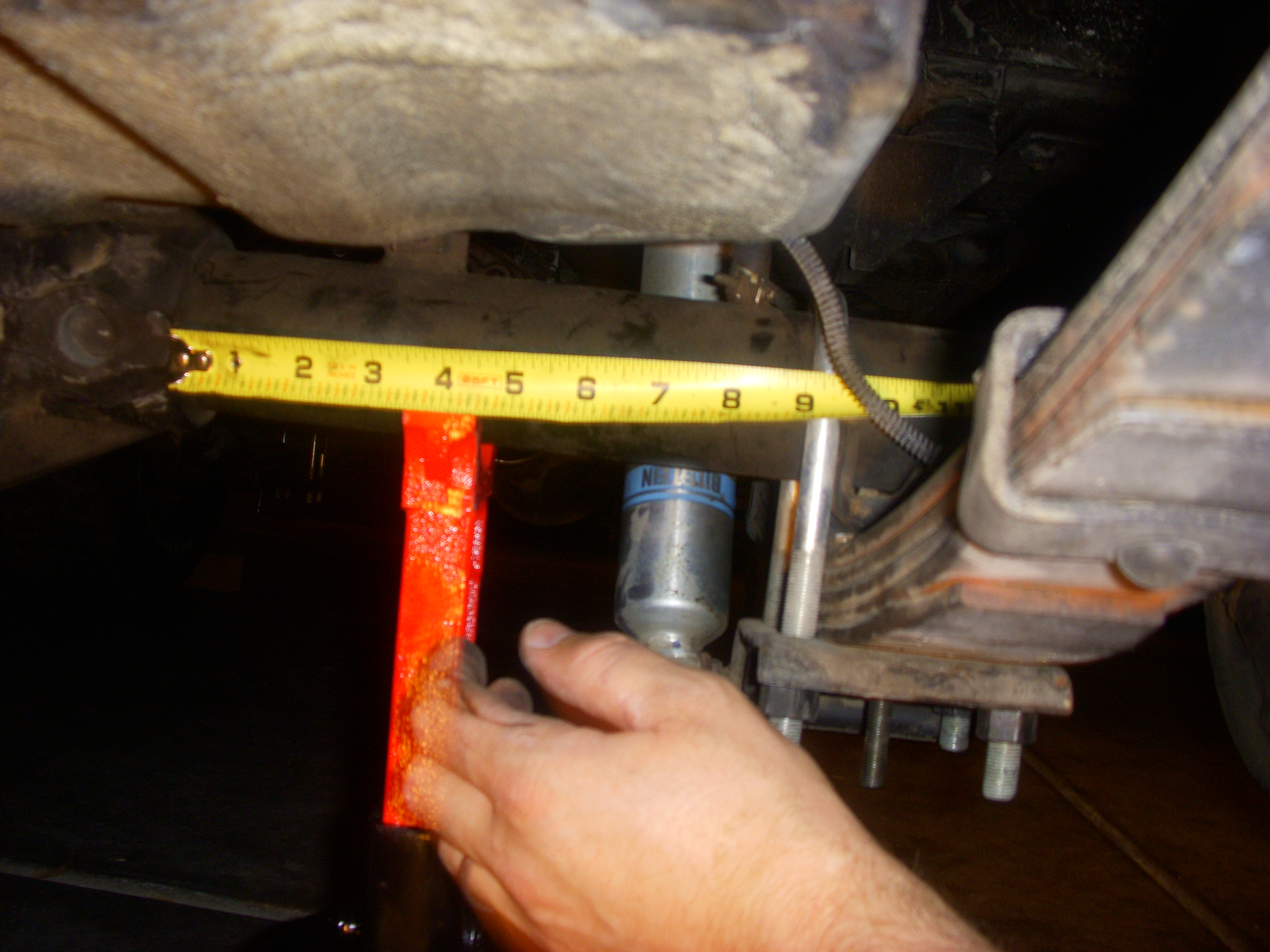

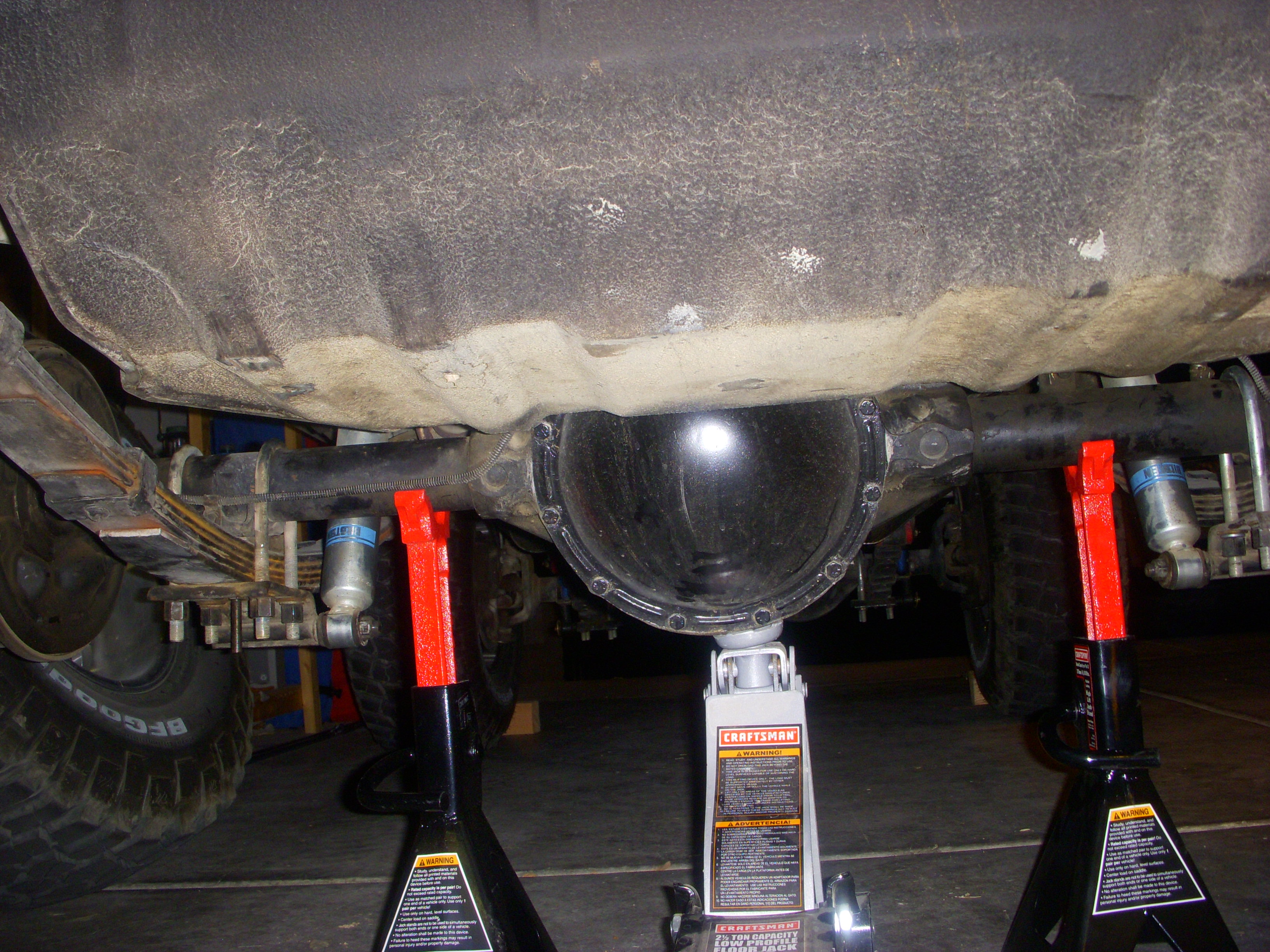

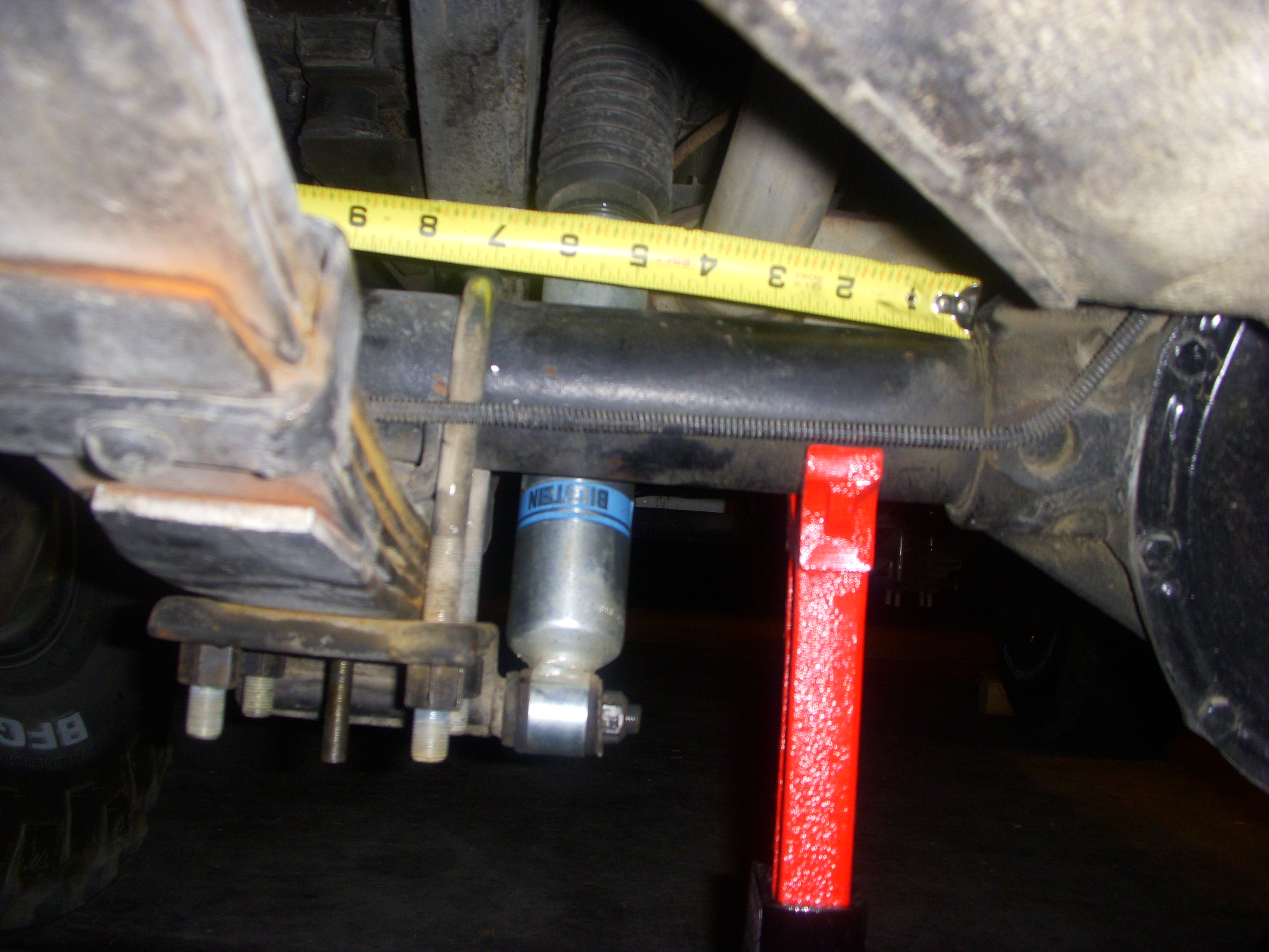

I just got it down off of stands. A LOT of axle grease all over the inside of the passenger side brake drum. I measured from the pumpkin to the leaf spring u bolts on both sides, here is what I got.
Drive side.
Pumpkin to farthest u bolt measure 10-1/4"
Passenger side measured 12-1/2".
Drive side...
Pumpkin to closets u bolt measured 7-1/4"
Passenger side measured 9-3/8".
I also noticed that there is a breather tube/line? on the passenger side housing that looks like it is in the spot where the u bolt should go to make each side equal.

Not all rear differentials are centered on the axle housing. For a more accurate measurement, I would measure from the backing plate to the leaf spring on each side to determine if the axle was installed correctly.

First off thank you for all the input I have been getting. I checked from the back of the drum to the side of the leaf, and both sides are within 3/8 of and inch of each other.

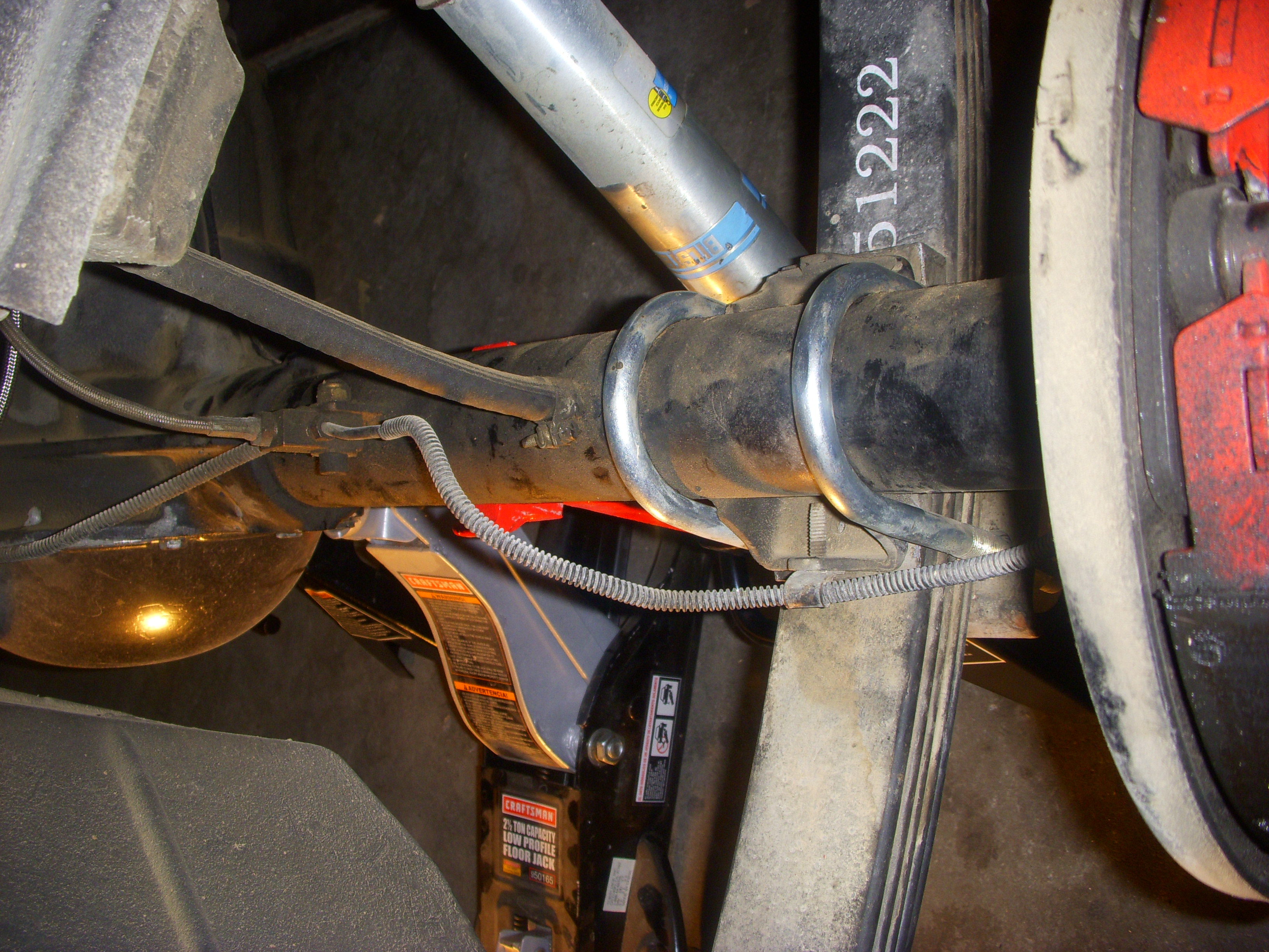

Here are more pics. 1st one shows that breather line? 3rd and 4th shows my original measurements. It sits off set to the passengers side and cocked in the wheel wheels. Towards the front on the drivers and rear on the passengers.

Yup, that's a Model 20 rear axle. The vent tube is where it's supposed to be. I will take measurements on my CJ7 with the same rear axle as yours for comparison. I will post as soon as i get it.

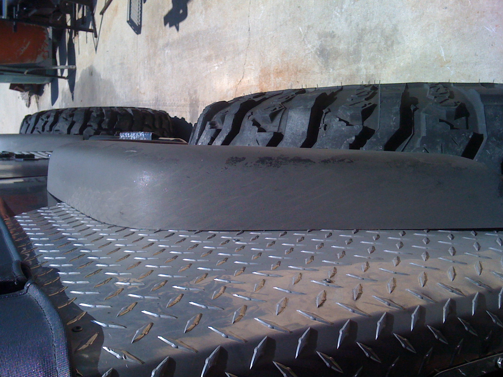

Since your rear AMC20 rear axle is a wide track and mine is a narrow track ,the measurements from the axle flange to the edge of the leaf springs(outboard) will be different from mine, However, it should be the same from the differential housing to the inboard edge of the springs. I measured 7 1/2 inches on the driverside and 9 5/8 on the passenger side. I also took a picture of the tires profile from the side to compare to the offset on yours. EDIT: sorry i forgot to flip the pics around.

So there is a possibility that your body has shifted from the frame. The best way to tell is to check from the front frame toawrds the body and then rear frame to the body tub. Also measure the distance of the body side to the frame on both sides. To answer your question on the difference between the AMC narrow trac and wide trac, the narrow trac was used on the CJ's from 76-81 and the wide trac was from 82-86. Some CJ's came out with the Dana 44's in 86 after the Amc 20's were used up. From 1976 -78 the rear brake drums used were the 11X2" and after 78 the 10X1.75 drums were used.From wheel to wheel, the wide trac is 54.5" long and the narrow trac is 50.5". Both are 36" from spring pad to spring pad.
The body looks jacked up. I can see about 1/3" of the rear vertical frame rail or what ever it is called on the passenger rear by the gas cap. And the body is about 1/8" over that same bar on the drivers side.
