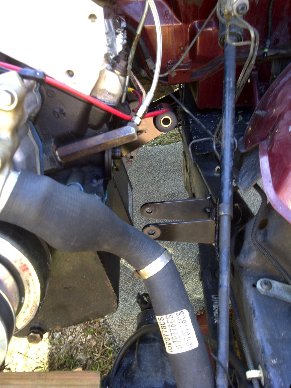

I finally got the engine, trans and transfer case in the jeep this past weekend. It went pretty well overall. The mustang fox body radiator hoses even worked out perfect with a little trimming. I did not move the engine back due to driveshaft concearns. It appears that i will have about a 12 inch driveshaft when i am done so i didn't think i needed to shorten it any more than it already will be. I also kept the skid plate for now because we ran out of day light. The engine sets at a 7 1/2 degree down angle in the rear and most driveline companies and factory specs recomment 8 degrees of angle. I think i can live with that. The motor mounts worked out nice and appear to be very strong even though we welded some gussets in to beef it up. The engine does set more to the passenger side due to the 8.8 rear end pinion offset.
We also welded the rear end mounts, shock mounts and we made some mounts for some axle braces that will come off of the lpw rear end cover. I sent the rear end to a friend that sets up my gears aalong with a new ford racing 4.56 gear, new ford racing 31 spline limited slip differential, new parking brake shoes, new axle bearings and seals and a new unit bearings and shim kit from rattech. The rear end should be just about bulletproof except for the stock axles. I priced all the other parst such as calipers, rotors, brake lines and such but have not purchased them yet.
When the rear end comes back to me, i will get it in and get started on the work that i can do underneath the jeep such as putting the gas tank back in, running fuel lines, brake lines and painting. I just dont like to lay under something on jack stands.
All in all, i am very satisfied with my project and the direction that it is going. It seems that everything is just as figured in my initial measurements and figures. It took a long time in the beginning to come up with a reasonable driveline that will be streetable and strong enough to handle the abuse it may encounter. My advice to anyone considering this type of transplant is to do some homework and try to consider every angle and your project shoudn't give you much problems. My only issues with the stock jeep engine and trans combo is that they seem weak and not very durable. Keep in mind that this project came to light after canning a mustang foxbody car. I am a ford man through and through and it was hard for me to consider any other option for a drive train.

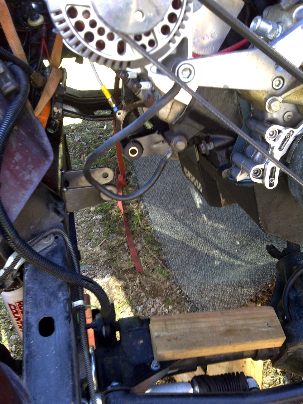

Here are some pics of the install, more coming later

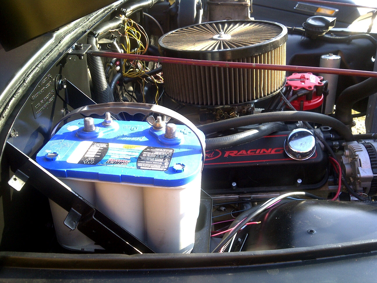

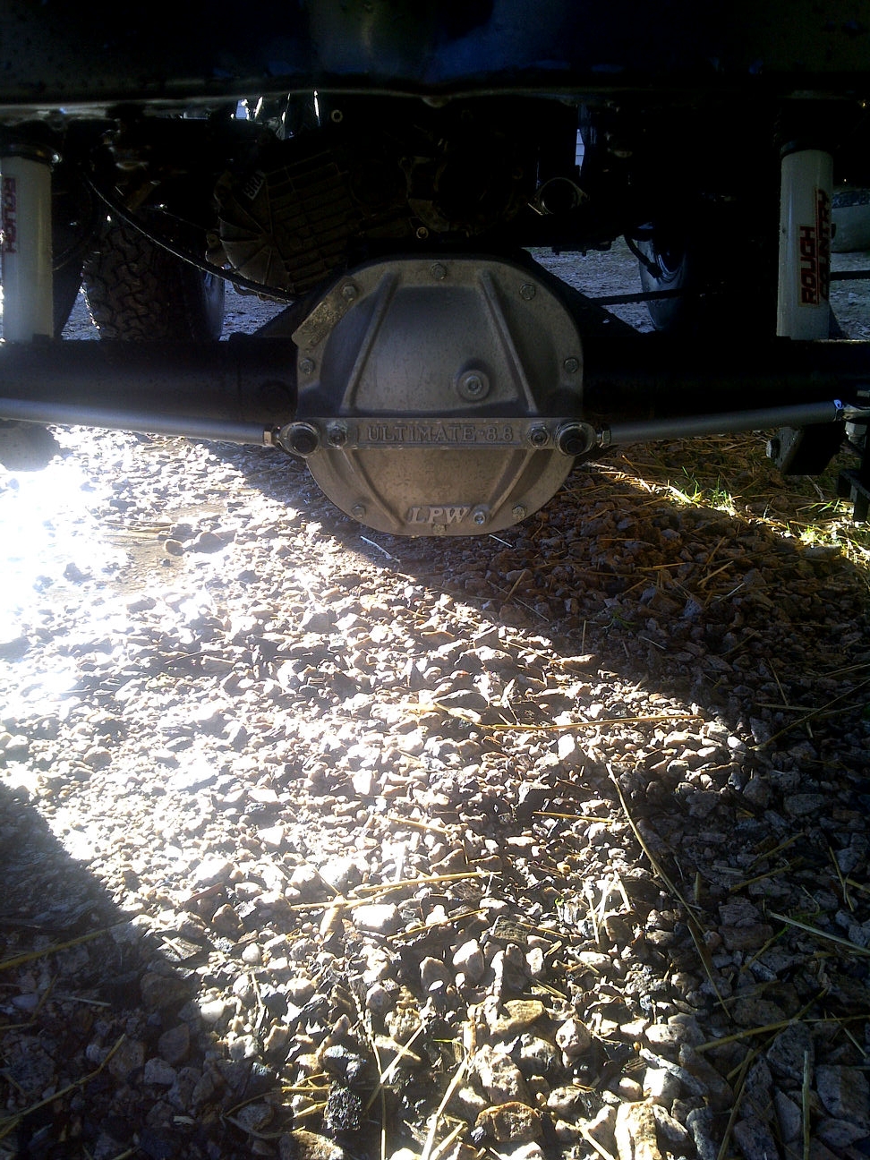

I got the rear end in the jeep this weekend, here are some of the newest pics of the progress.

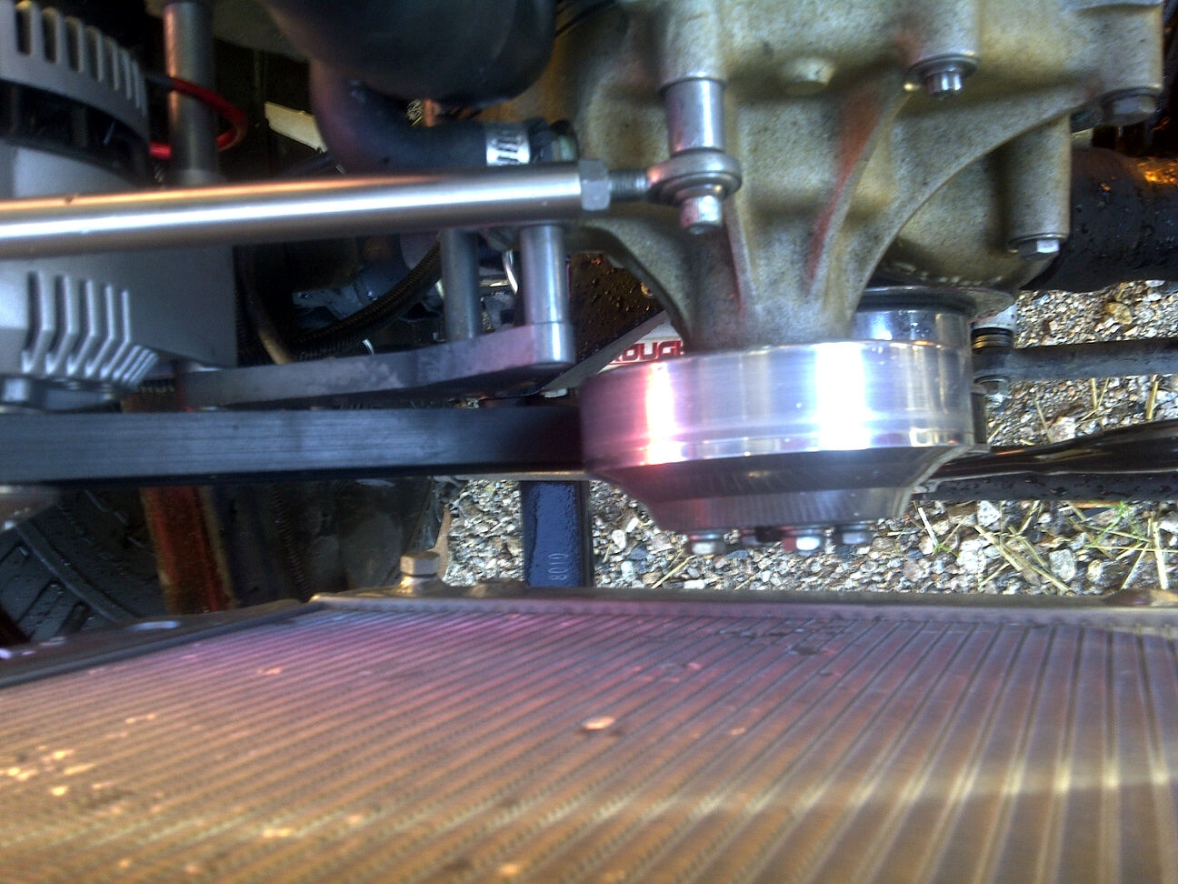

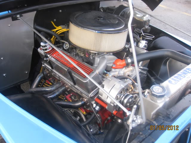

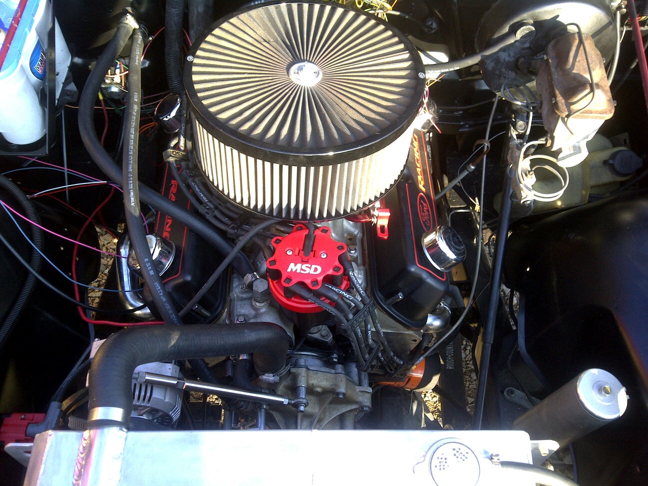

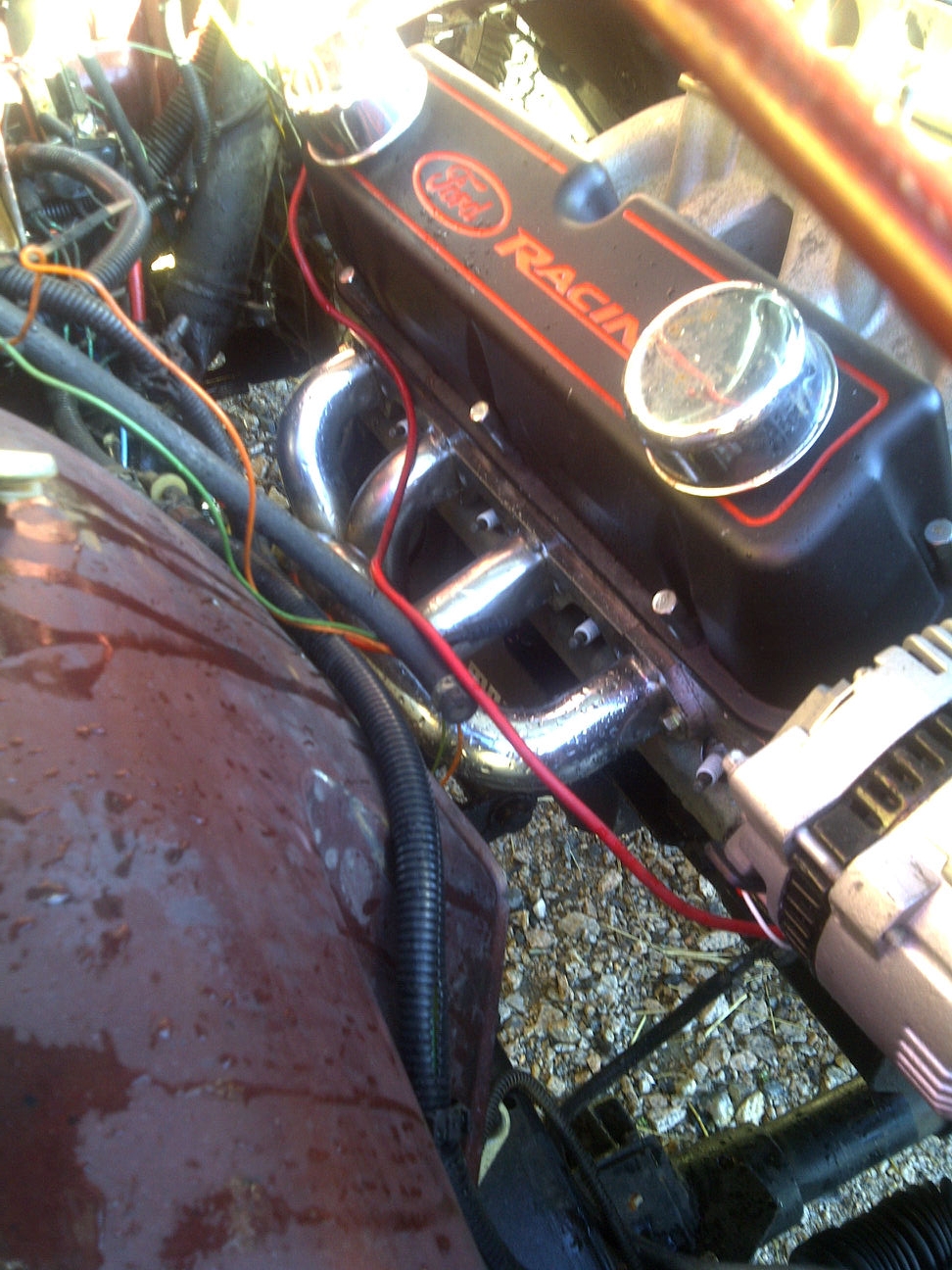

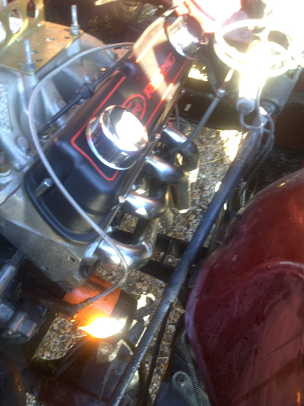

Update: I have been playing around with my jeep the last couple of weeks and here are a few of the things that i have accomplished.
I pulled the wiring harness out of the firewall sleeve and started cutting on some of the wiring that is not relavent to my conversion. A lot of the wiring looked as if it went to a hook up to do diagnostic related things. Well, it's not there anymore now. I also cliped all of the wires going to the electric gauges since i am going mechanical on the gauges.
I also lined up the body and tightened all of the body bushings
i hooked up the radiator hoses, installed the starter, headers, some ground wires to the engine, and the wires to the starter. My plan over the next couple of days is to take the dash out and to delete some more wires to make things a lot more simple. I also will replace the heater core so that it will not be an issue later on. When i accomplish those couple of things i will plumb everything and hook up all of the ignition parts.
I do have a little bit of painting around the windshield and under the hood as well as some body work to do on one rear corner of the jeep but will do that at a later date. Until then take care all......

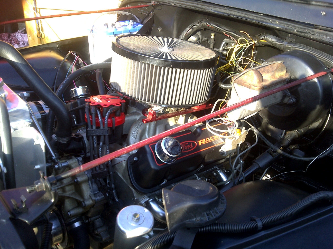

This is what a new years weekend of working on the bignasty1987yj looks like
