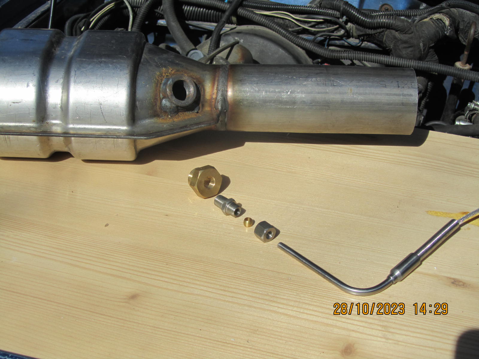

Here is the plan for the new cat and 'couple..I have welded an M18 boss into the outlet end of the new cat , then there is a reducing bush from M18 to 1/4NPT, then a nut and olive fitting for the K type thermocouple.
I have now got the braided cable through to the inside of the car using the old conduits.. Next is to attach some blade connectors for the little black box.
