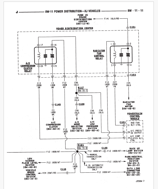

I have attached a diagram for the fan relay which seems to show that it's controlled from the ECU.

does your other fan turn on when you hit the button to turn the ac on? the second fan should come on when the ac is on.
and you applied power to the other fan motor and said it works so its either some wiring from the ecu to the fan, or the ecu, like you said.
can you get all the numbers off the ecu? i haven't been able to find the one you listed
Thanks again for the interest. Unfortunately I can't check whether the aux. fan comes on with the aircon as it looses its gas due to a leak somewhere so the pressure switch shuts it down. It works if you bypass the fan relay, so it's electrically sound. For some reason the ECU is not bringing it on due to coolant temp. It would be incredibly difficult to test the wire from the ECU to the relay as it's buried deep inside a big harness somewhere. My feeling would be that it would be OK as nothing ever disturbs the harness.

It is in the diagram posted. I doubt there is a different block for RHD vs LHD.
You could verify your new temp sending unit by measuring resistance between the connector points while the engine heats. No change bad sensor.
Check continuity at the PCM/ECU connection.
Reset ECU connectors.

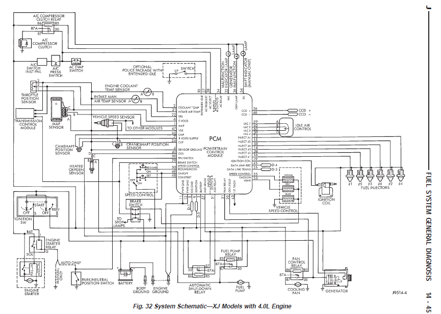

Thanks for the info. There are a number of differences in the RHD version but I have worked my way through all the tests you mentioned as far as possible. My temp sensor is a thermistor not a thermostat as in the diagram so it changes resistance with temp, it is not an on/off action. I checked the new one before I put it in and it's working OK. The signal from the sensor definitely goes to the PCM and the fan relay is operated by the PCM. The only bit I have not checked is the wire from the sensor to the PCM but that's all inside the harness. I have attached a wiring diagram for info.
I have started to wire in a bypass for this by putting a manual switch on the dashboard. I'll connect into the contacts on the fan relay base and remove the relay. The aircon is not working anyway.
