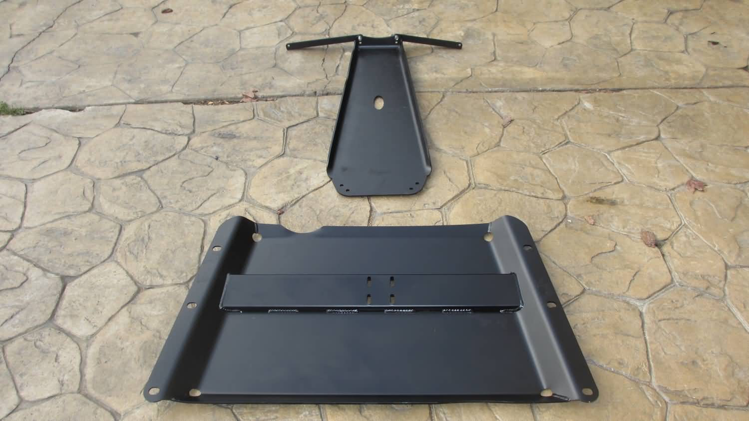

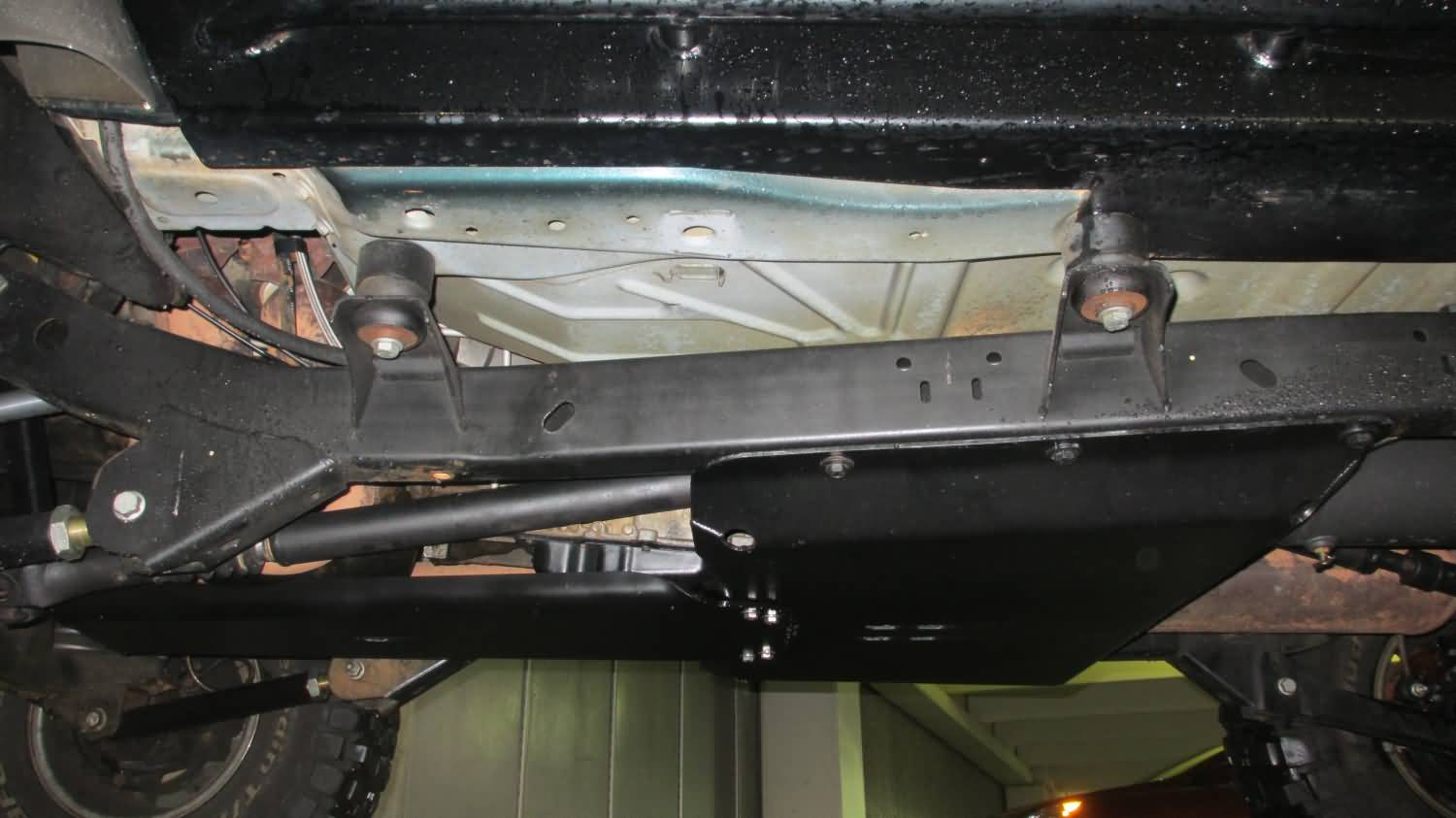

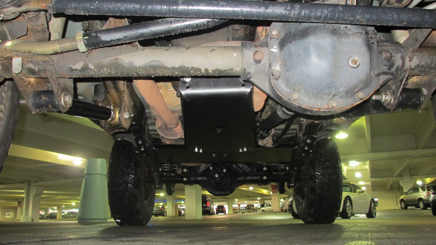

Undercover Fab Extra Clearance Skid Plate

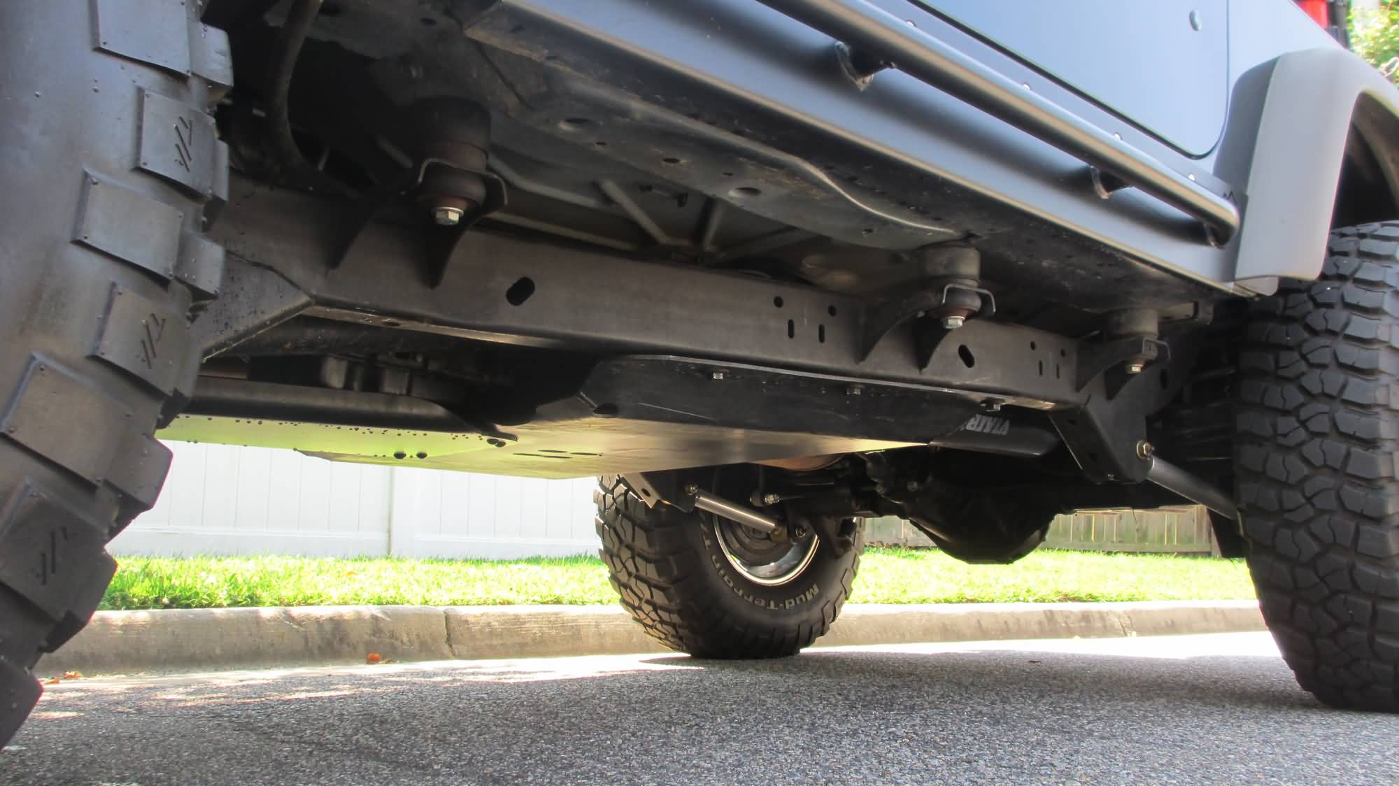

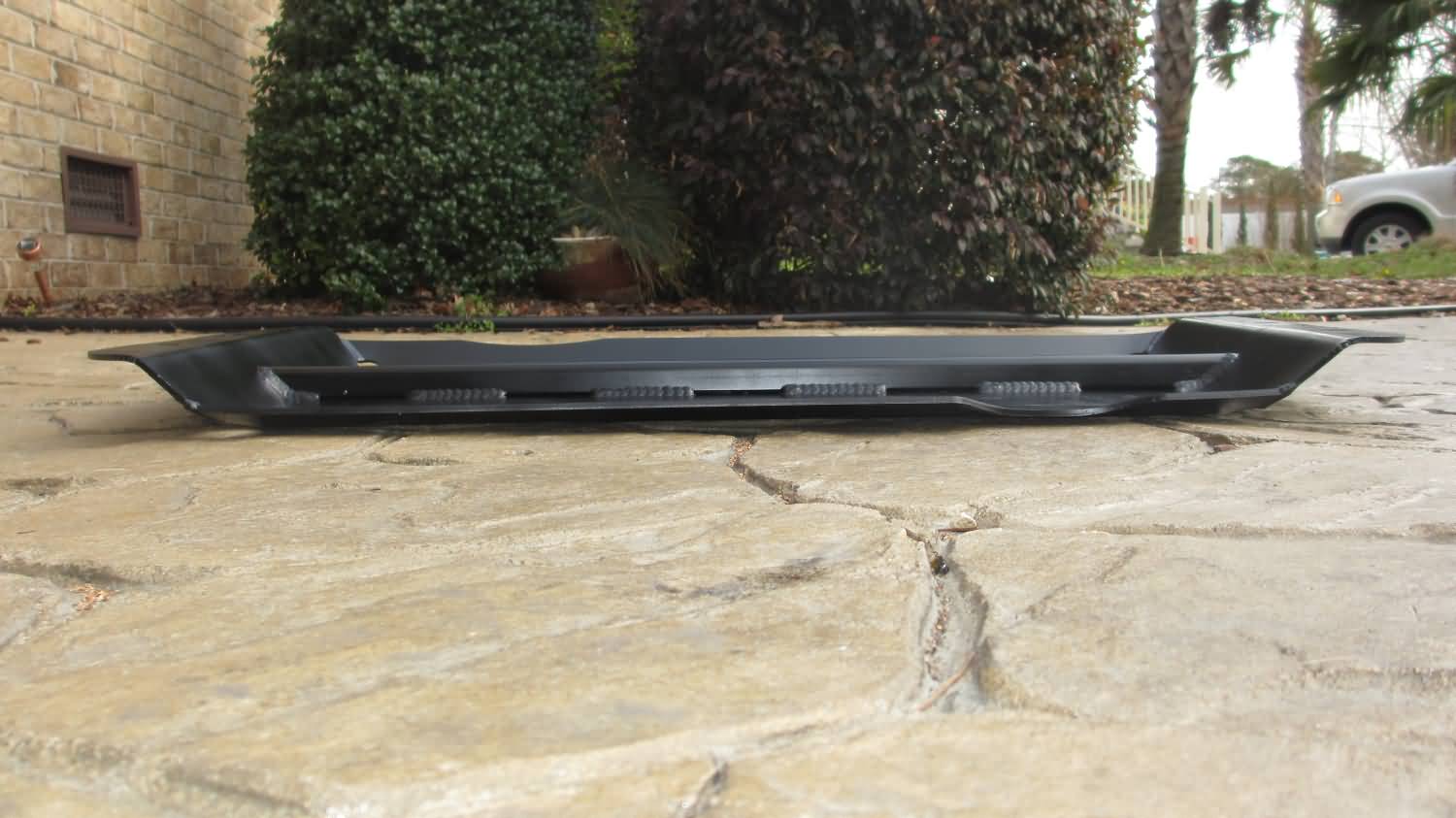

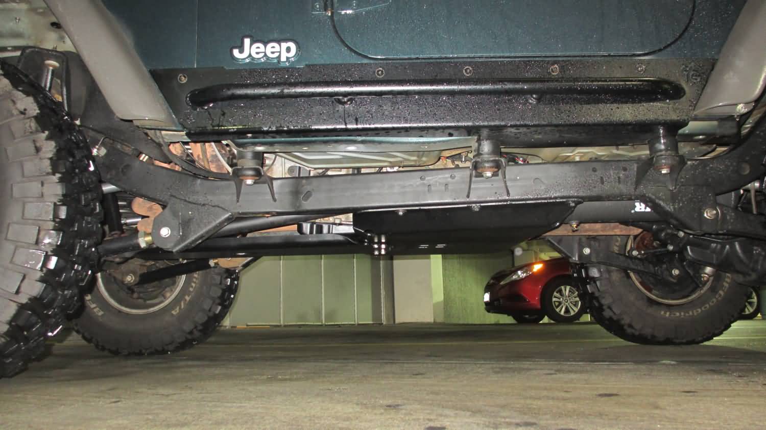

I decided to ditch the original skid plates - they hang alittle low for my taste. After some research I ended up with the Extra Clearance Skid plate from Undercover Fabrication. I bought the Extra Clearance which requires a body lift (it has a two inch drop to it), as well as their engine skid. The install was pretty easy, and the only holes that need to be drilled are to connect the engine skid to the transmission skid (you are actually drilling 4 holes in the transmission skid).
Here's the kit I bought:
Under Cover Fabworks, LLC - UCF Deep-Cover Skid Plate System
I haven't taken it on the rocks yet, but the system fits nicely (It really hugs my automatic transmission pan).
Touche' Sir, I never even thought of that. I do run 456's now, so he is actually giving me a pretty good deal re gear, locker install and ready to bolt in. soooo I may end up with that. I honestly never even thought about the disc brake set up allowing for that. Thats why I love the forums. Thanks and I will keep you posted.:pray:

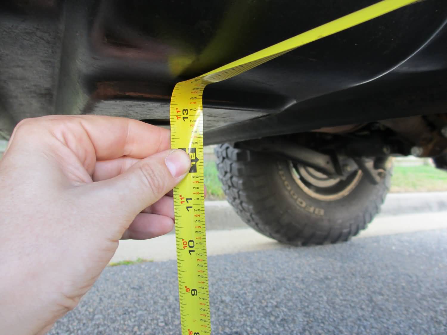

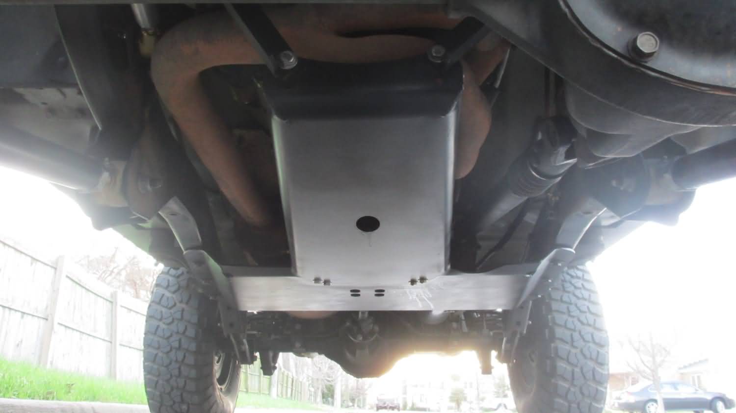

UCF skid plates - before and after

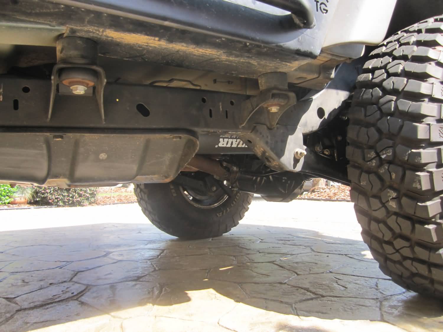

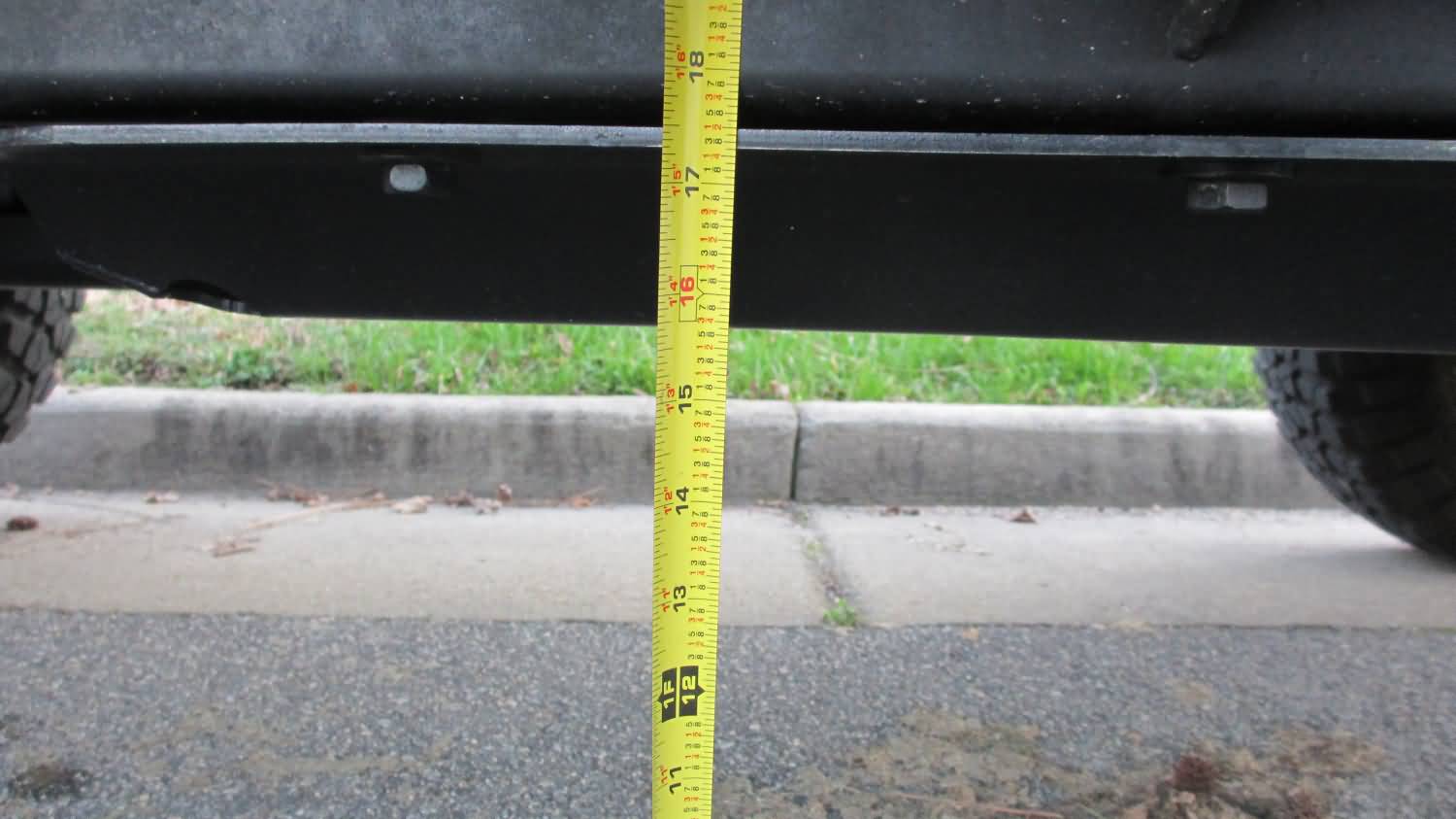

Here's some before and after on the Undercover Fab skid plates.
Before - 13.5 inches of clearance
After - 15.5 inches of clearance.
You can tell it's a bit smoother underneath as well
Before:
After:

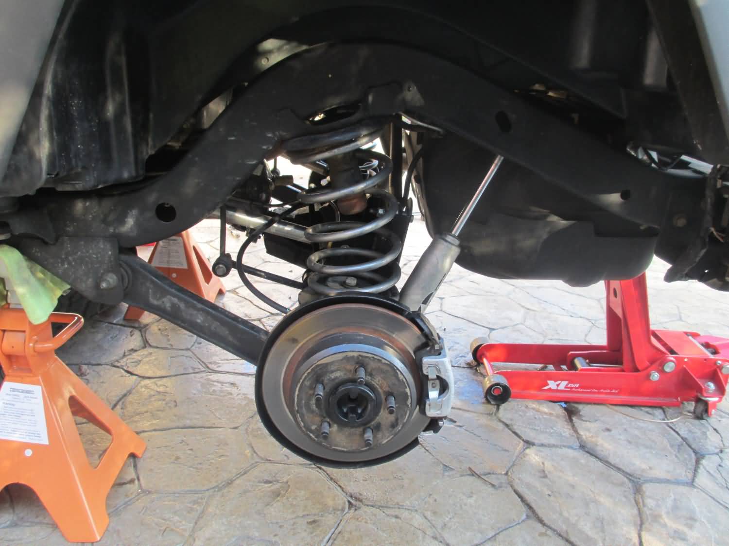

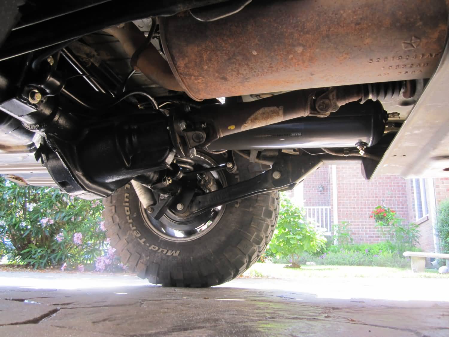

Re: Ford 8.8 rear axle
Just curious if you know your rear brake calipers are supposed to be mounted on the rear of the axle? I think you have the backing plates on the wrong side
If you look at the picture of when you brought the axle home, the brake calipers are in the correct location on the backside of the axle. In the picture of when its done the brake calipers are on the front side of the axle. You need to pull the calipers, and backing plates and move the right side to the left side and vise versa.
You're totally right. I never even noticed it. I guess I have some work to do tonight. It may make my e-brake cables reach a bit farther as well. Thanks for the heads up.

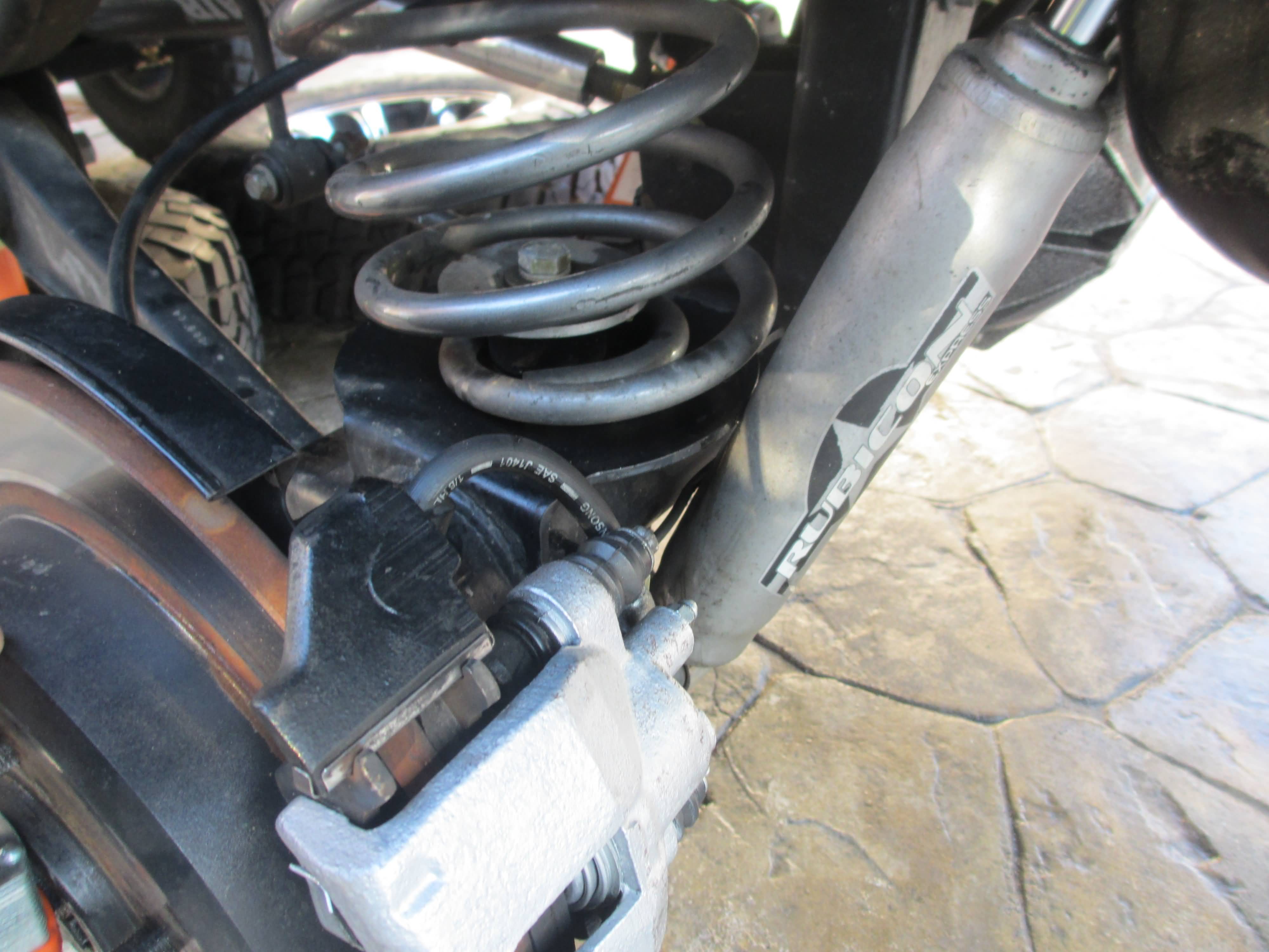

Bump stops?
I do have bump stops installed (the stock cup with the bump stops from my 2 inch kit). I haven't taken the time to flex things out and see if they are spaced correctly. You can see what I mean here:
15864d1357752355t-terrymasons-2005-jeep-tj-build-img_4559-wrangler-savvy-control-arms.jpg
Is that what you meant, or something else?
<img src="http://www.jeepz.com/forum/attachment.php?attachmentid=16299"/>

For the bump stops. I didn't see it in the write up, nor an image post springs to see the delta of shock travel to bump space. Plus it is important for someone following the thread for their modifications.
I spent some time this weekend and straightened out the brakes. I ended up having to pull the axles out, which meant draining the diff and pulling the c-clips... I didn't think much about it before starting, but laying on the cold ground covered in stinky gear oil is no way to spend a Saturday night :cry:
Thanks again for pointing out this problem. I really didn't notice, and now I think I've picked up some needed slack in my parking brake cable.

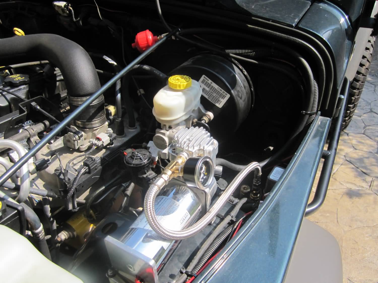

Jeep Onboard Air

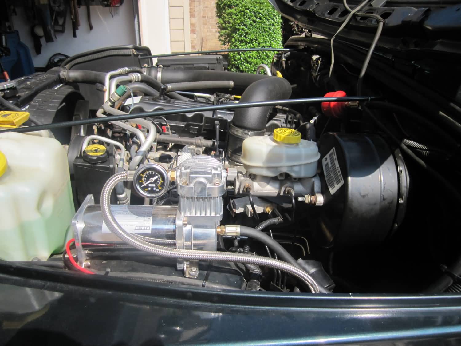

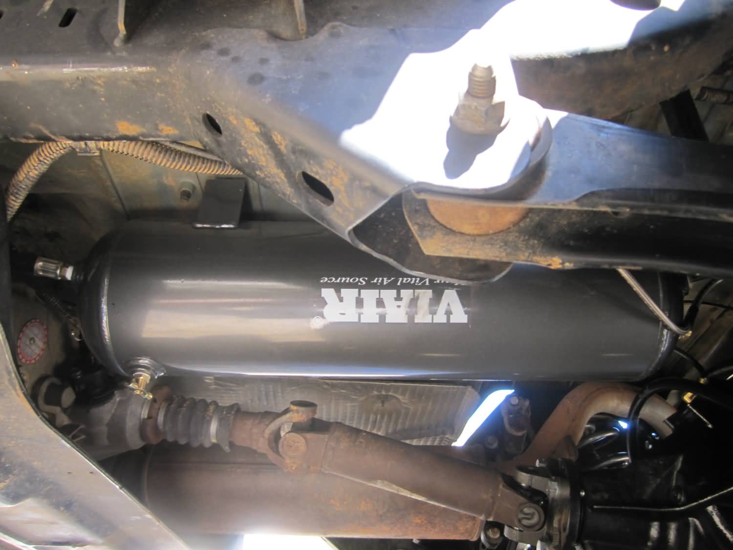

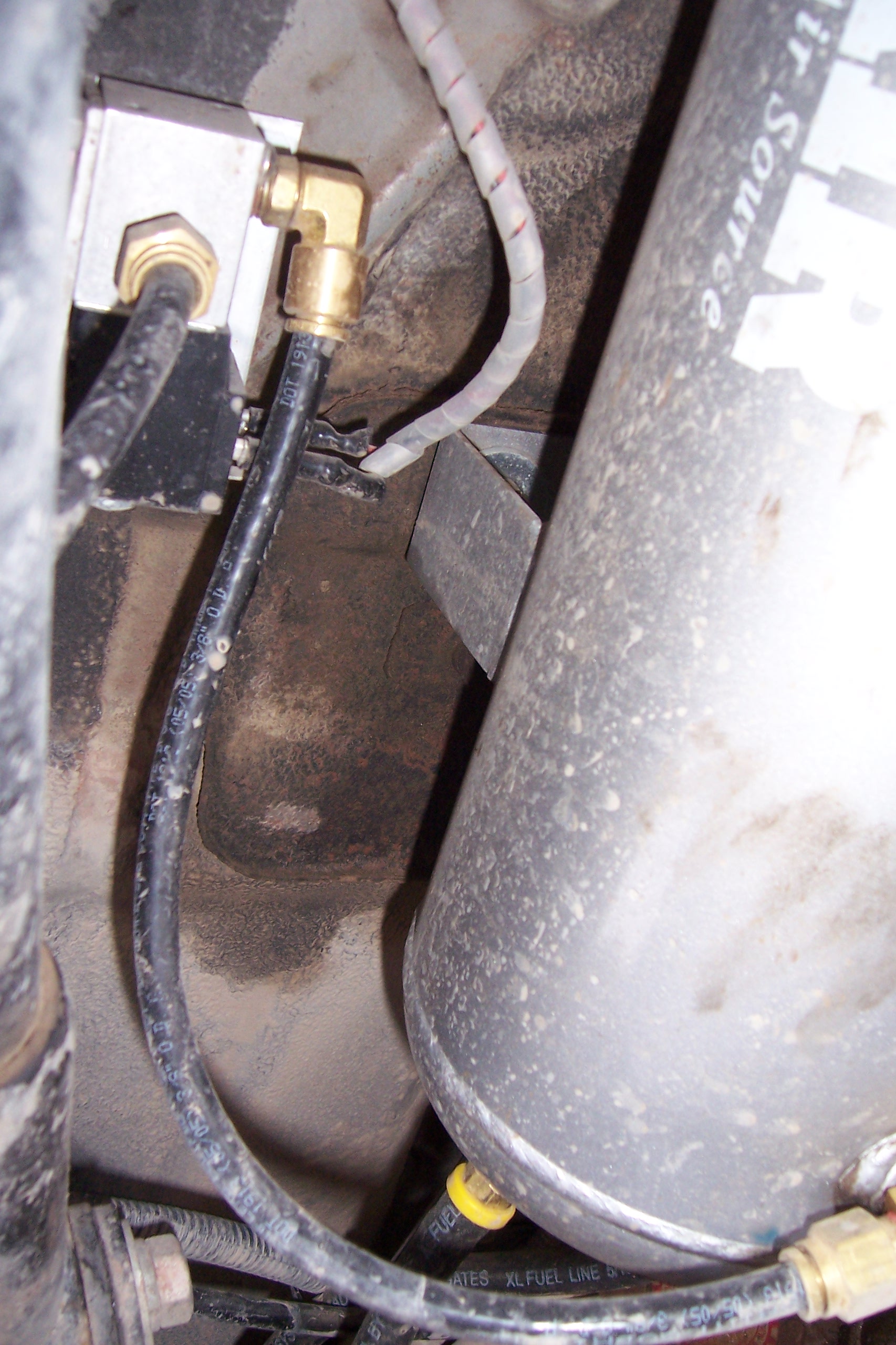

I got this compressor from a guy at work, and decided to hookup some On-board air for the old Jeep. I sprung for a Viair 2.5 gallon tank (model 91028) and some standard compressor hose and rigged everything up. I've got a switch mounted with my other stock switches to turn it on and off, a pressure regulator to keep it from going over pressure, and a tank that I hook a hose to when needed.
Just a few pointers Terry, run your air in-let line through your fire-wall too much dust, oil, and possibly water. and get rid of that cheesy "manual" tank drain. Go to Graingers and get a 12v air valve and hook it up to a switch...lazy mans tank draining.
Hey just noticed something...looking through your build thread...your mounting everything like I did....quit copying me!

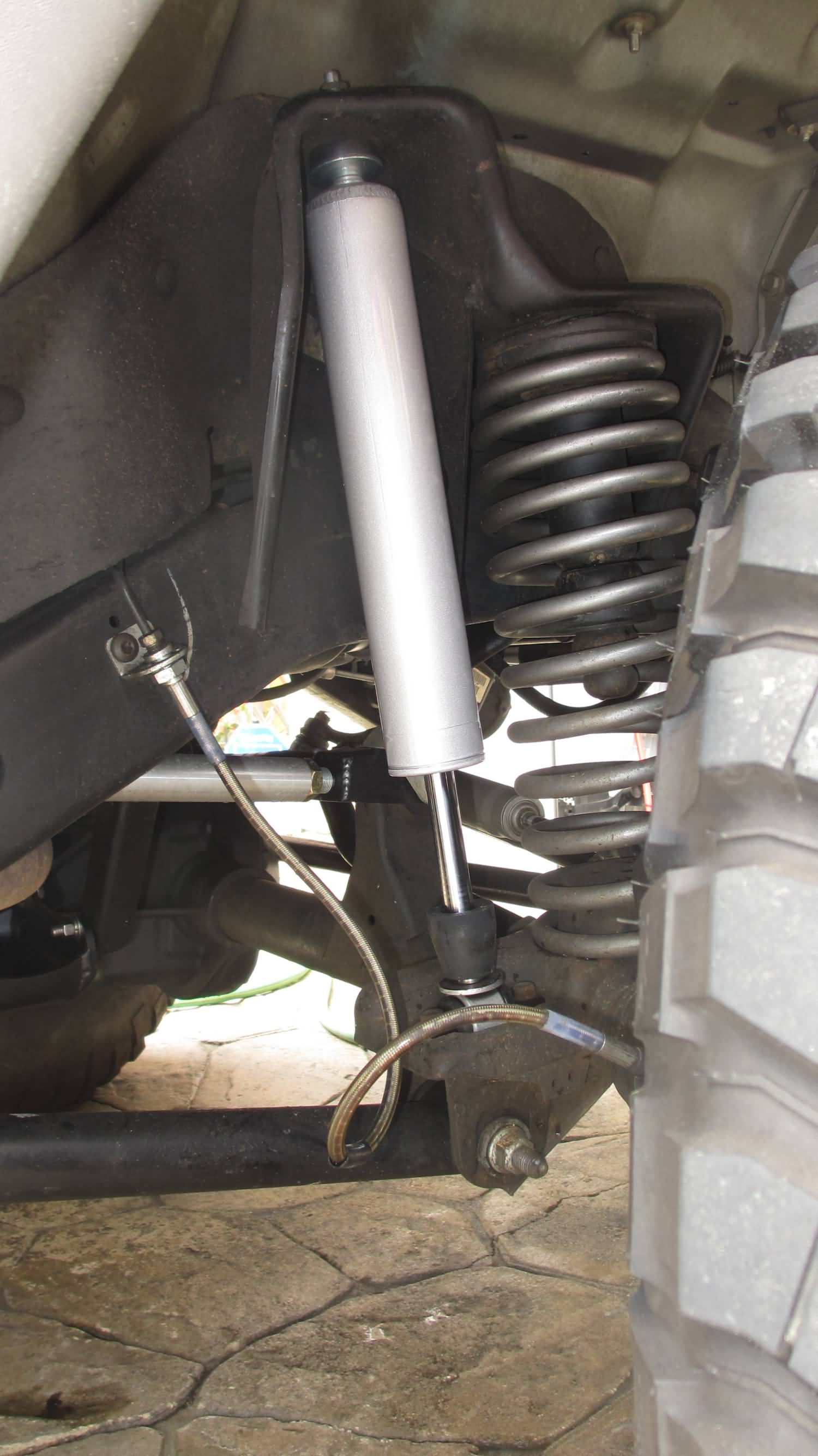

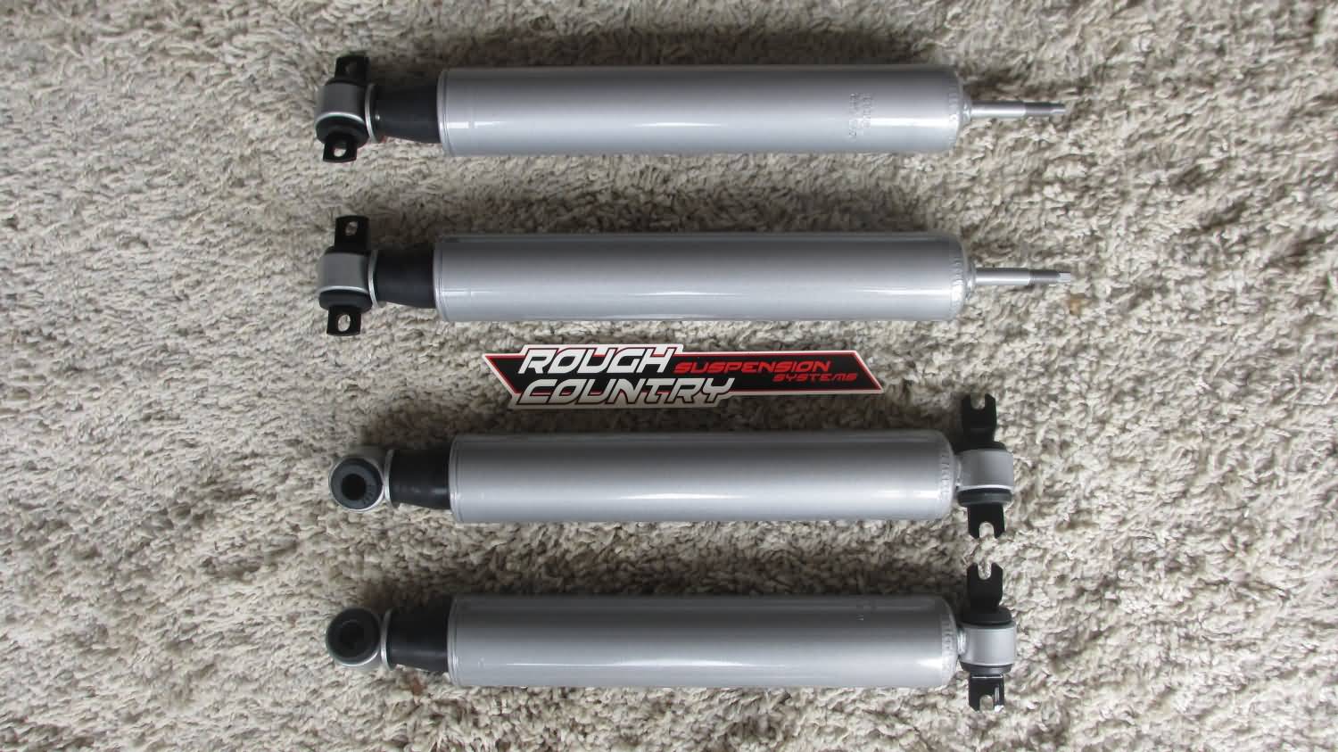

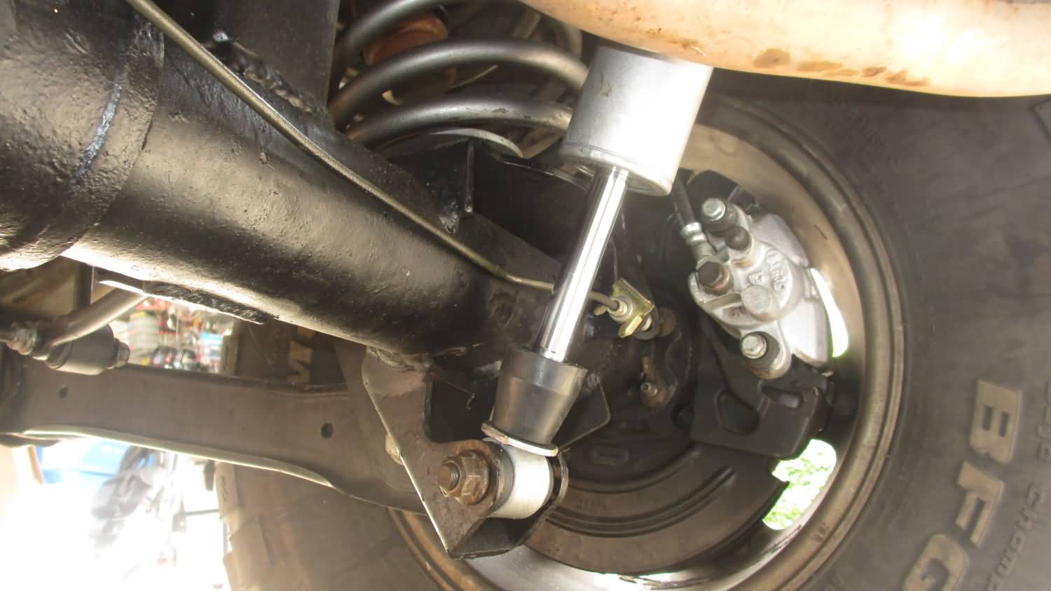

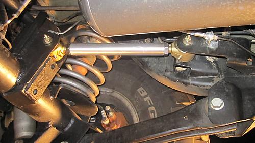

Shocks
As I mentioned, the rear axle / coil bucket was hitting my shocks as the axle flexed out. I bought some shock extenders, but ended up not using them.
I decided instead to use some new shocks that mounted upside down (can up). It seems to have worked out nicely.
These are the Rough Country 22004 and 22005 shocks. They ride fine, and look pretty slick. The best part is that now there's plenty of room for my axles to flex out.

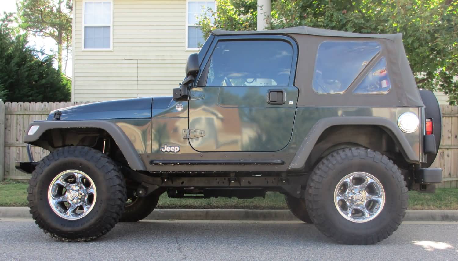

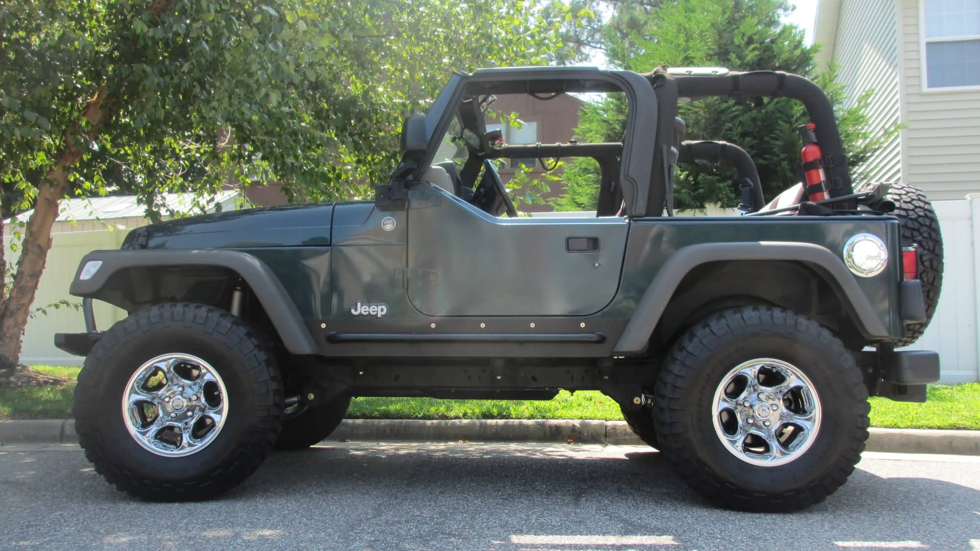

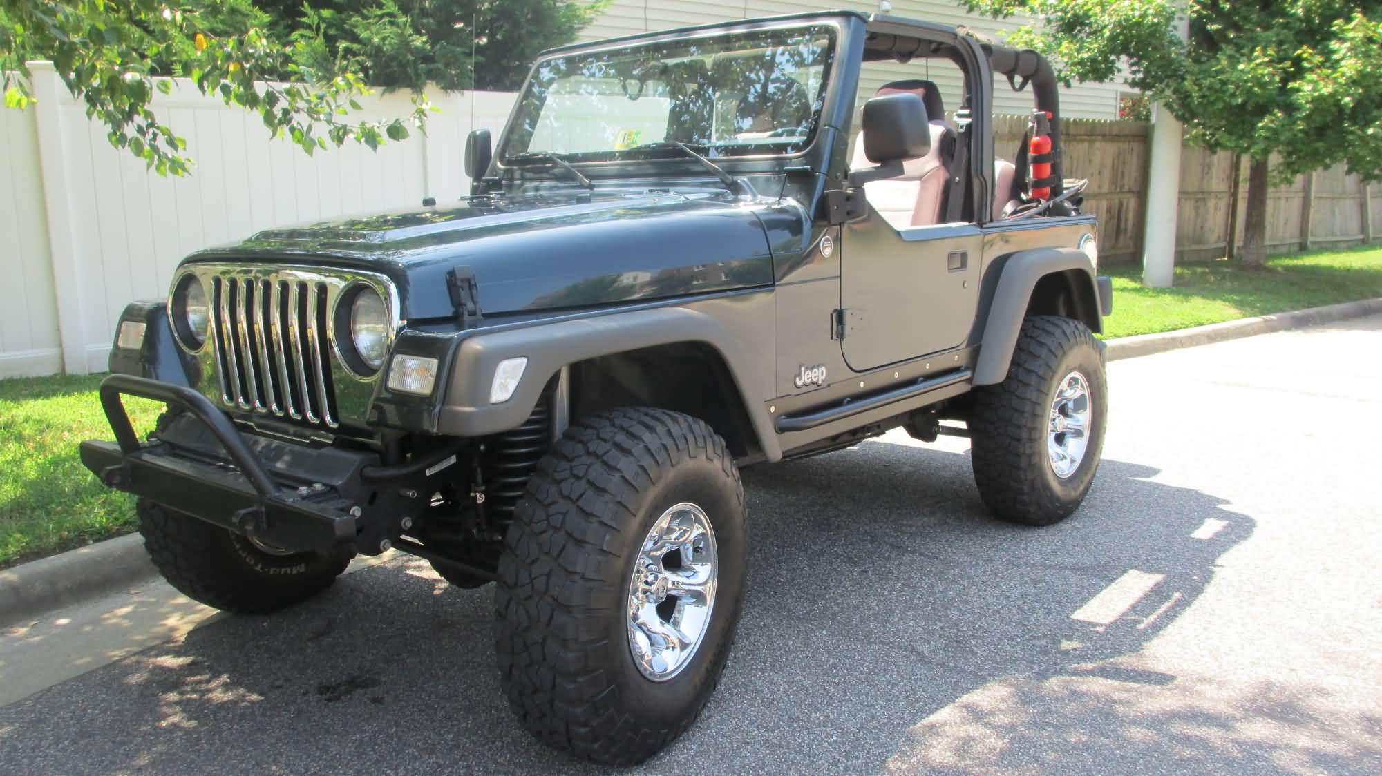

I thought it may be time to tally up everything that I've done to the Jeep so far. Here are some photos of my Jeep now:
And here's the rundown:
2005 Jeep Wrangler SE (4.0L, Automatic)
33" BFG KM2s
Rough Country 2.5" lift springs
1.25" JKS body lift
Savvy / Currie aluminimum adjustable control arms
Ford 8.8 rear axle (with rebult factory LSD)
SYE with cut down Cherokee CV driveshaft
Aussie locker in the front axle
Undercover Fab low profile skid plates
Viair onboard air with 1.5 gallon tank
Trail Gear rock sliders
Ground Pounder Fab front bumper
Exogate spare tire carrier
There are plenty of other little odds and ends, but these are the big items.
