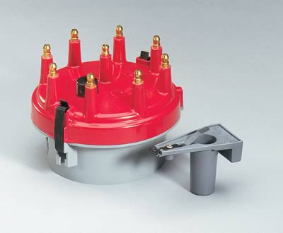

If you have a Ford distributor on your CJ you should be able to use parts from a 302.
