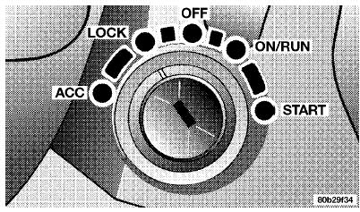

SteelHeadz and Bounty_Hunter both pointed out my mistake...
Do not turn the key to the "On" position but rather the unlocked "Off" position. You should not have anything illuminated on the instrument panel but the steering wheel will remain unlocked.
