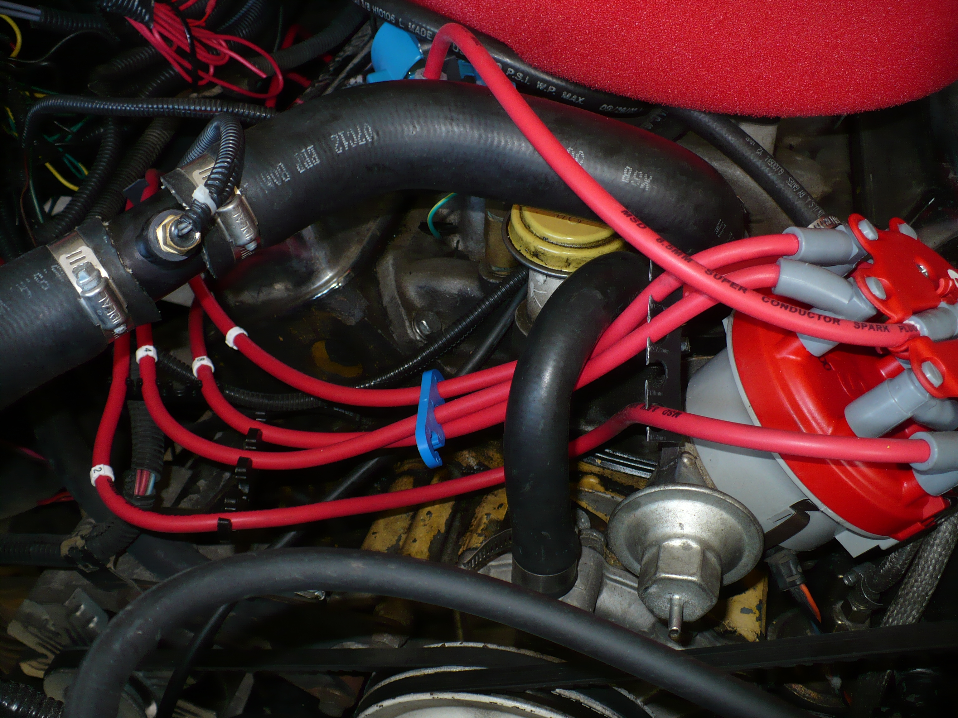

Yesterday after work I modified the route of the right bank spark plug wiring to go under the Bypass hose maintaining as best I could the wire seperation. When I get some more kazooks I'll get more wire sperators, or make some. I was getting Handyman magazine for a while and they kept sending me 'bonus' plastic bolt sizers. For part of this I cut a couple of rows off and used them as surrogate wire seperators.

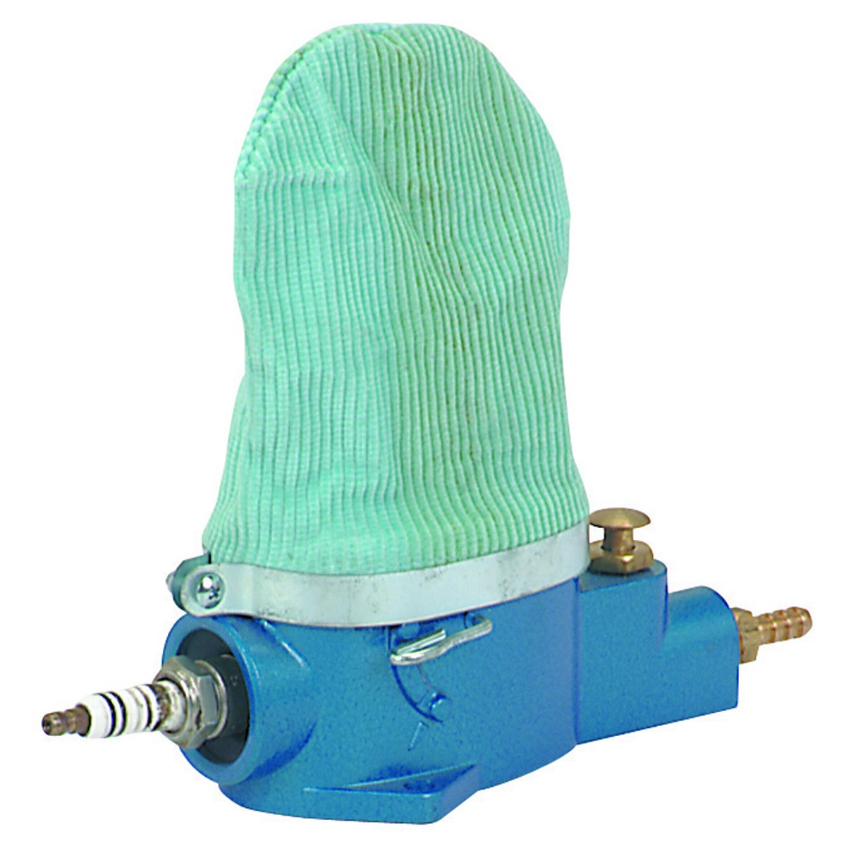

I also got some more fine blast media and cleaned up the fuel fouled 65's I had on hand from a couple of years ago. I don't have a lot of faith in HF stuff but for cleaning up spark plugs this dingus air spark plug cleaner
works pretty good. I got 'em all installed but for the odd angle on #8 I heard that distictive crunch that meant I broke the porcelain so I had to pull it and clean up another one. By the time I got done it was two hours after dinnertime so I called it a day. I may try starting her up tonight.
I re-routed the wiring for the right bank to go under the Bypass hose to get it away from the Coil wire
