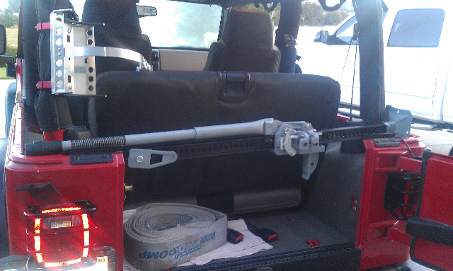

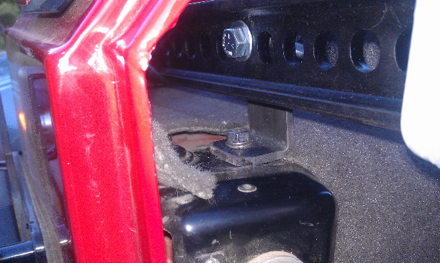

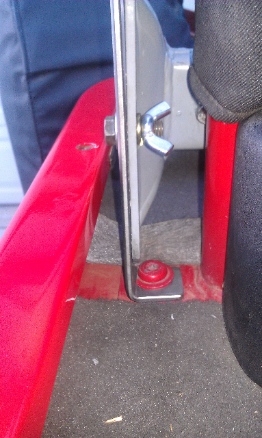

Finally installed my hi lift jack. It's only been sitting in the garage for nearly a year.. 2 pieces of 3/16" band iron, thru in a couple 90 deg bends, and 4 drilled holes. Mounted using existing holes: rear door striker and rr roll bar anchor point on top of fender tub. Maybe $10 in materials, most I had laying around. I'll try it for this trip to see how it goes. May come back and modify it more then shoot some paint on it.
PS: Jack measure 55" and so jsut barely fits in that space...!
Success!! Install off road tested this weekend A day and a night trip, total 30 miles.. Jack stayed in place perfectly.

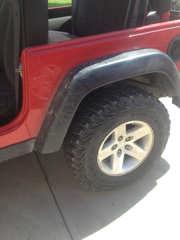

Fixed the E-brake and got a new set of Kevlar enforced Goodyear wrangler MT-R's put on.
