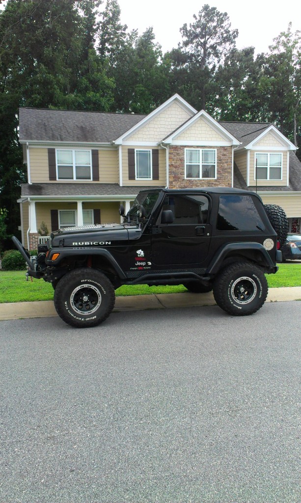

As for the install, it only took about 45 mins (probably could have done it faster if I would have let the top sit in the sun), no issues with the install, great fit, and is a lot quieter than the factory soft top when doors on and windows rolled up.

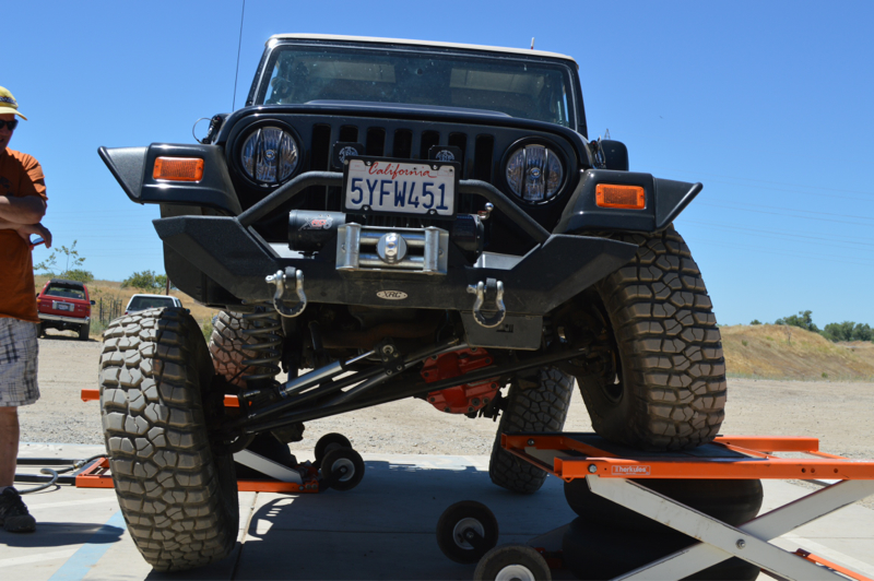

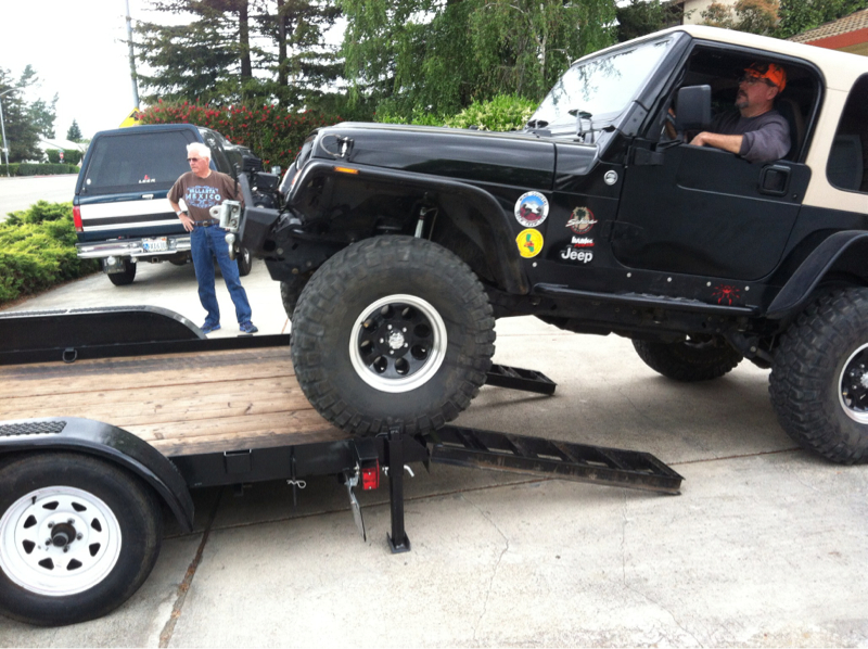

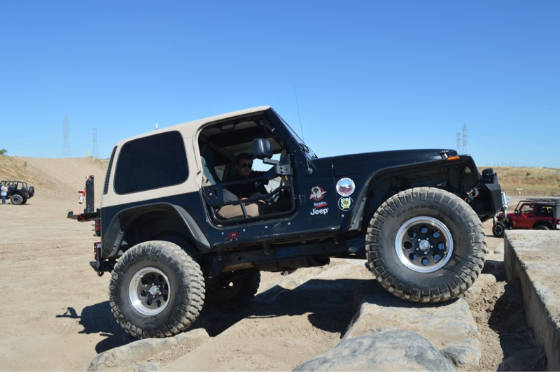

Going on a trip to Ice House Reservoir next week, then the build begins. Al though we've tricked out the trailer, I want to drive it to some of the shorter trips. The 4.88's are coming out and 4.10's are going in. The Atlas II will take care of the low gears. Also putting in a Rokmen high clearance belly pan. Pictures to come.

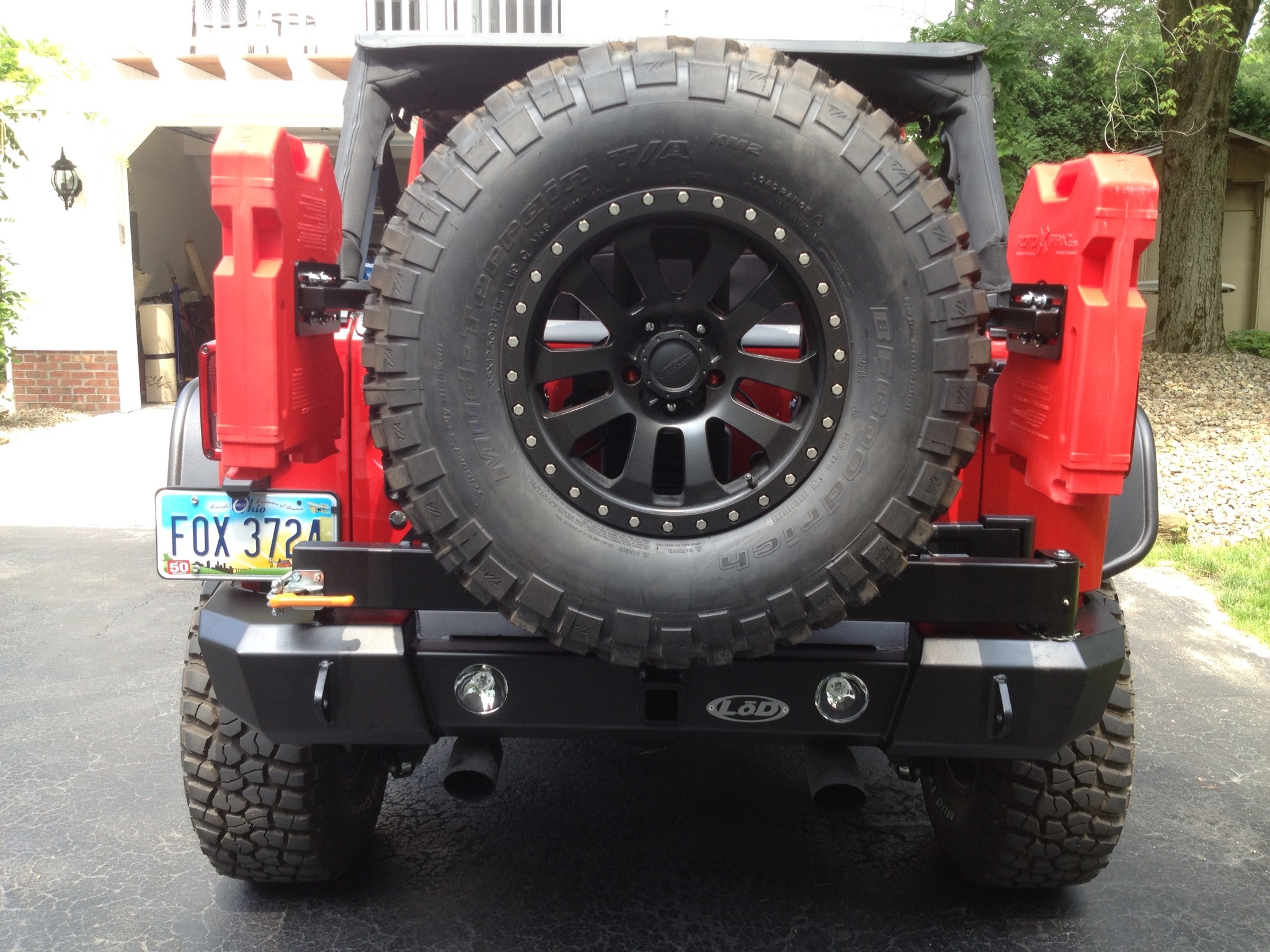

Not exactly today, but over last couple days I installed a LoD rear bumper/tire carrier.

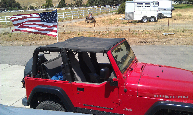

Put the top down to enjoy the wonderful weather today

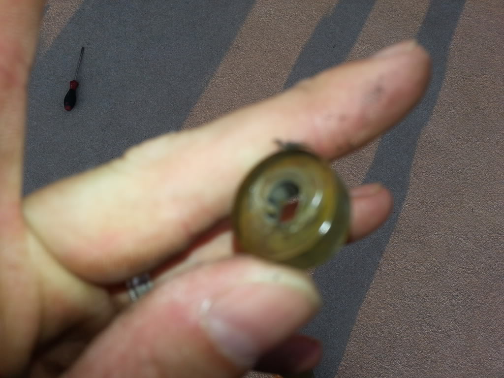

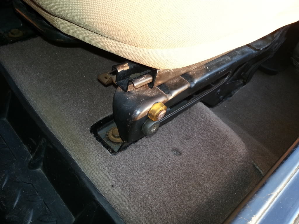

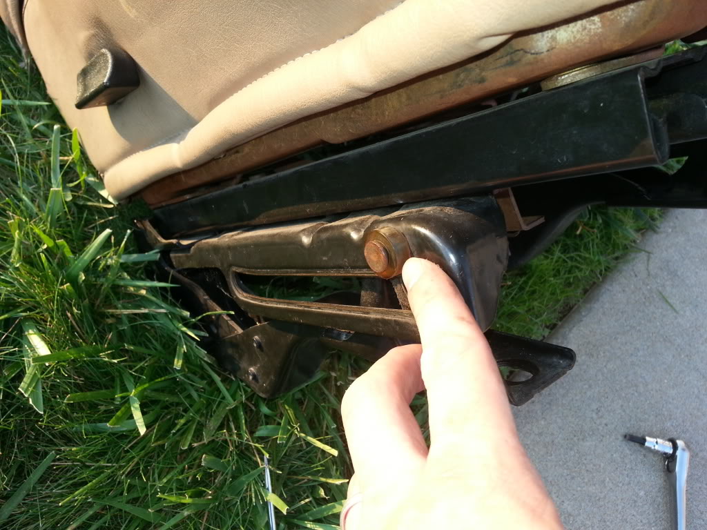

After replacing my seats a couple of weeks ago I noticed they creaked and squeaked whenever I turned, took off from a stop or hit the brakes. I noticed the little bushings were missing on the new seat brackets.
I pulled them off my old seats and put them on the new, problem solved...

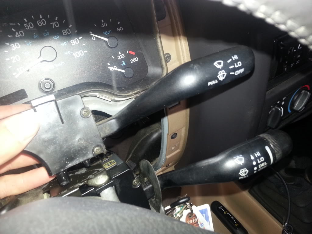

I put a delay wiper switch on, no more flipping wipers on and off!

I didn't know TJs had the option of non-delay wipers. Was it a simple plug and play swap, or was there more to it?
I install a pair of off road light rugged ridge had a JK hood shock lift kit
The early models did, also mine is a SE model. Yes its a plug and play swap for 97-00
Sent from my Galaxy Tab
Do you know if an 01 is controled at the switch too (plug and play). I have several spots that dont like that delayed wiper action.
