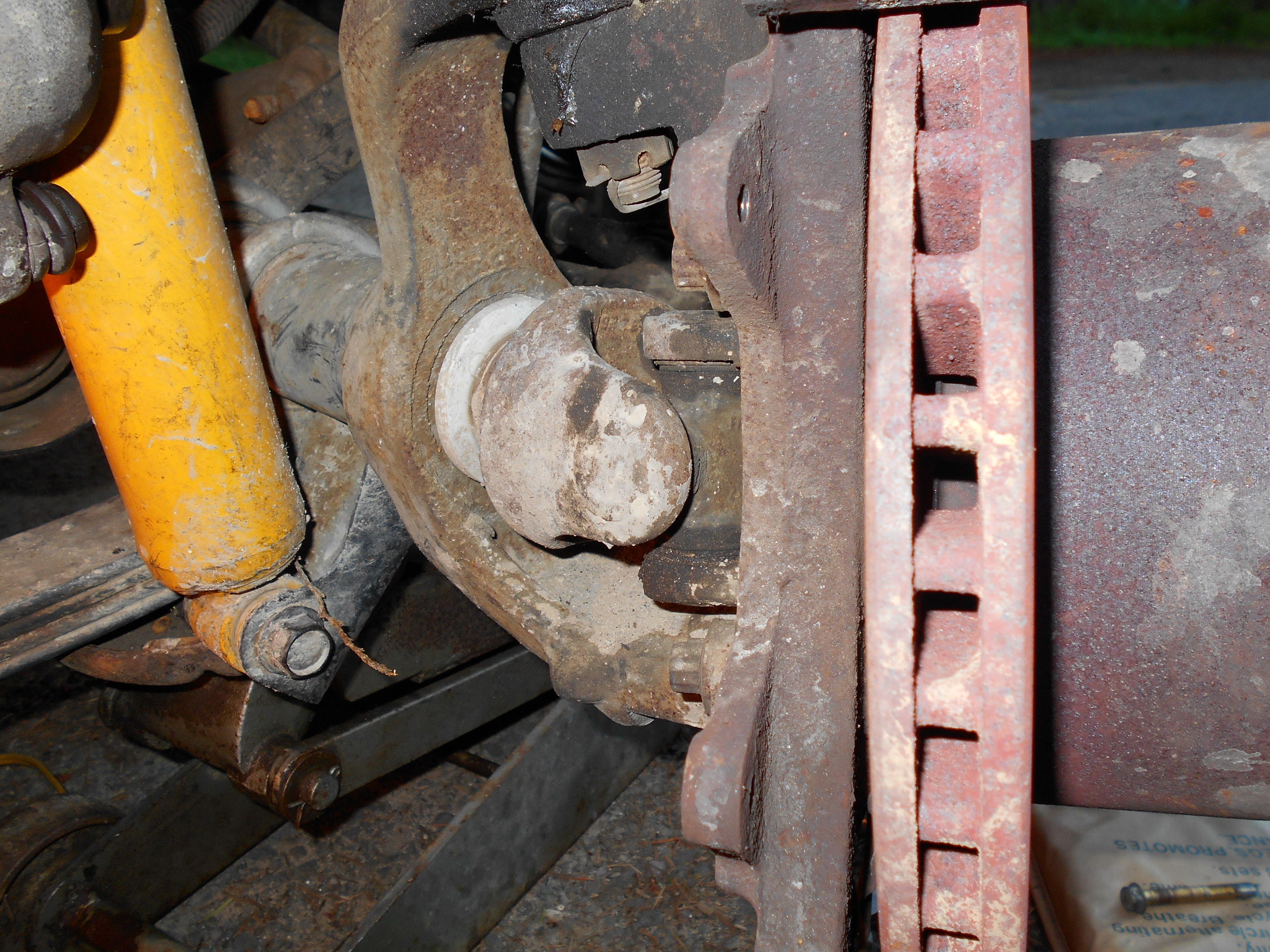

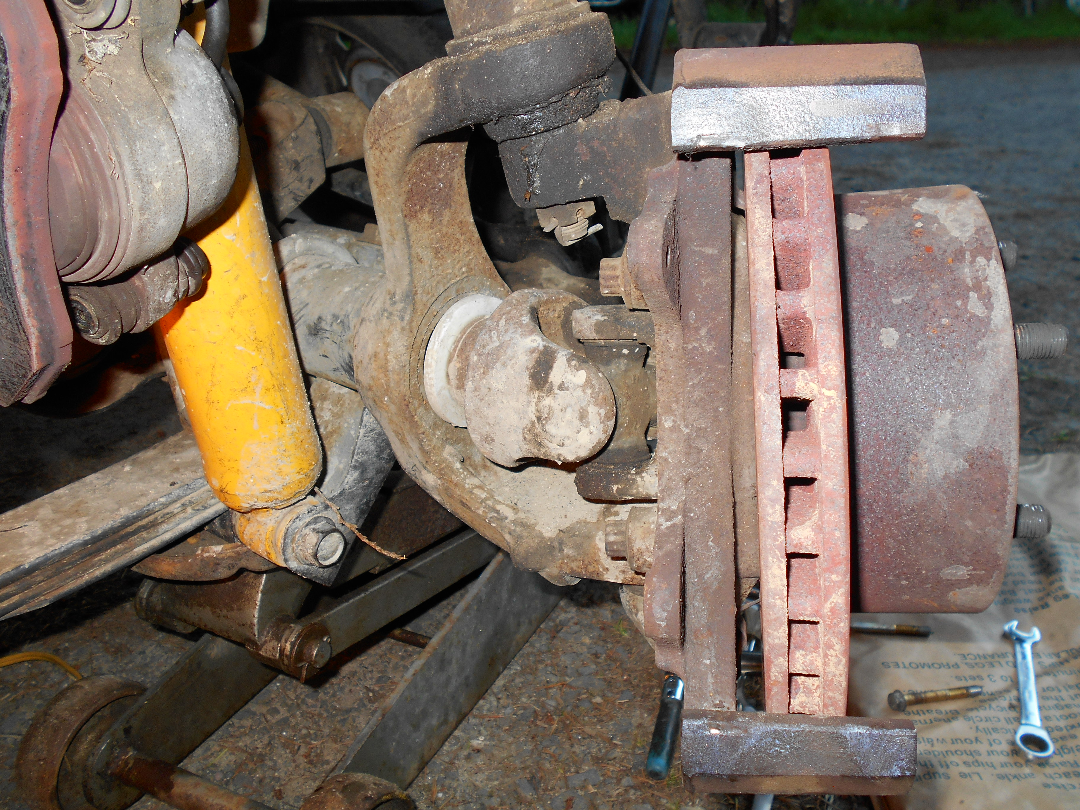

replaced front caliper on yj 1994
lets see if i can attach two pix.. there it is. note the bent caliper tab ! solved the mystery of why caliper ceased occasionaly. i plan to heat the tap and drive back into line. i did buy a new caliper (94 jeep yj used a GM caliper). vinn p.s. thanks monitor

You dood it. My oh my, yes, that does look bad. Worn out if you ask me. You need new ones.
well, today ill try to explain the two pix [above] showing the front rotor (94 yj). the two bolt caliper has been removed. note , one of the two bolt tabs is BENT. the caused problem was "occasional brake seize up", AND skid,smoke and PANIC. with torch and hammer, i put the tab back in line with its companion. $50 rebuilt G M caliper with an aluminum piston (instead of the fiber glass one. works good now. p.s. keep a 5 pound hand sledge hammer in the cab in case you need free one up ! so as to limp home. vinn

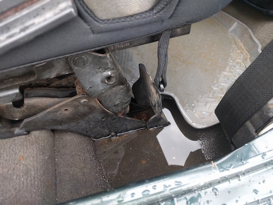

I had to take a wet vac to my Jeep to suck out all the rainwater.
I thought I could beat the odds on a 20% chance or rain.
