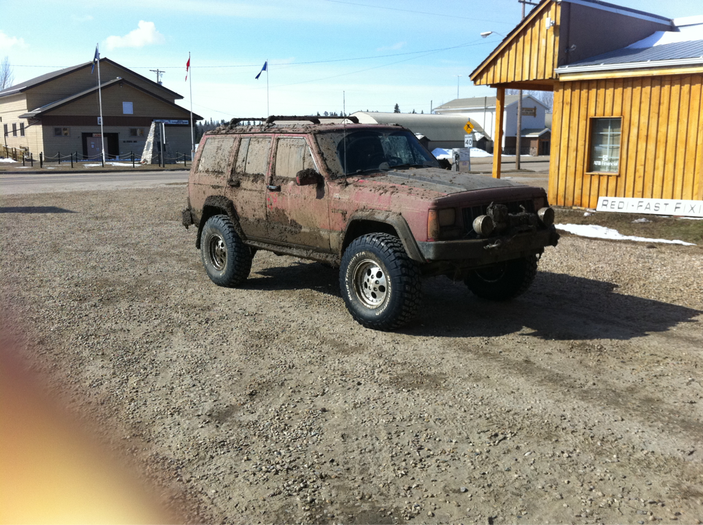

Spider trax spacers have the hub centers and fit the hubs. I run them and have had no problems. Trust me they take a beating. I run stock tj rims on my Cherokee with 33s. And the wife daily drives it and if I'm driving it the only times it's below 4500 rpm is if it's off. Lol
