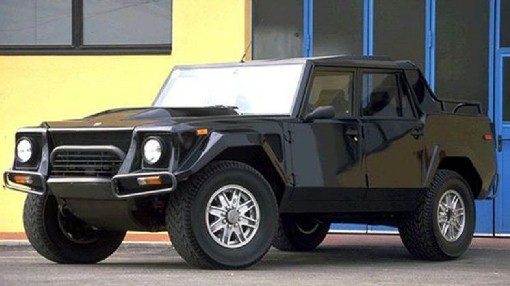

Well, since we are talking about fantasy here, I would just go ahead and sell the Jeep and buy one of these:
Although I would have to say I doubt the average American knows what this is (the Army did blow up one to show the effects of a car bomb without knowing how valuable a car they were blowing up!), it's probable the baddest production car ever built when it comes to sand, and probable the baddest stock engine ever put on a 4X4.
For those that dont recognize it, you can read about it here...
Honestly, I already have my fantasy Jeep, but wouldn't mind a few mods like a Cummins Diesel(i freakin love diesels) , 40" SuperSwampers with a 10" lift, power seats :D , Hardtop lol, power windows/locks, and deeper cup holders lol
I would rather keep the Lambo 12 cylinder engine (this IS a fantasy, afte all!)...
