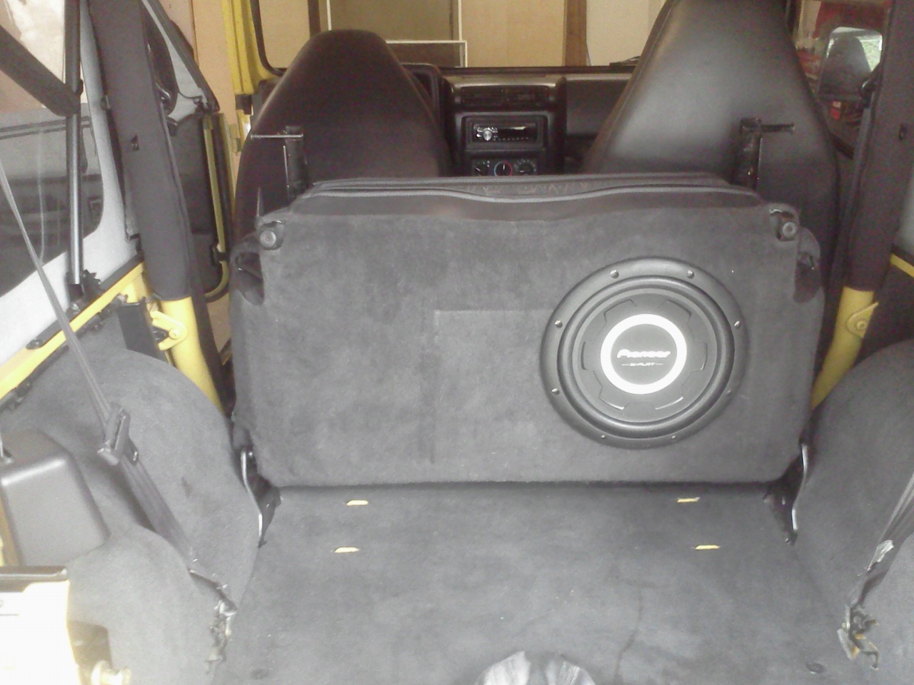

Good stuff. Here's my version.
Finished today. Sounds and looks great!
My wife's 1998 TJ has a little different seat configuration than those seen here already. Not too bad. A redesign of the box was required.

I'm in the middle of this build and it seems that my 10" pioneer shallow mount (3" depth) will need about 1/4" of additional depth on the downward slope side of the box.
Rather then add a spacer under the speaker ring, i'm contemplating just modifying the low side of the angle to begin at 7/8" instead of 1/2". It seems that this would increase the internal volume by about .05^3 ft and also allow the sub to fit with a tiny bit of extra space for the magnet. (about 1/8" clearance on the slope side)
Did you need to add a spacer ring to get your shallow mount sub to fit? Any thoughts on whether the additional 3/8" of depth on the short side would cause a fitment issue? The deepest part of the box remains unchanged, and it seems to me like the only sacrifice is a bit of comfort.
