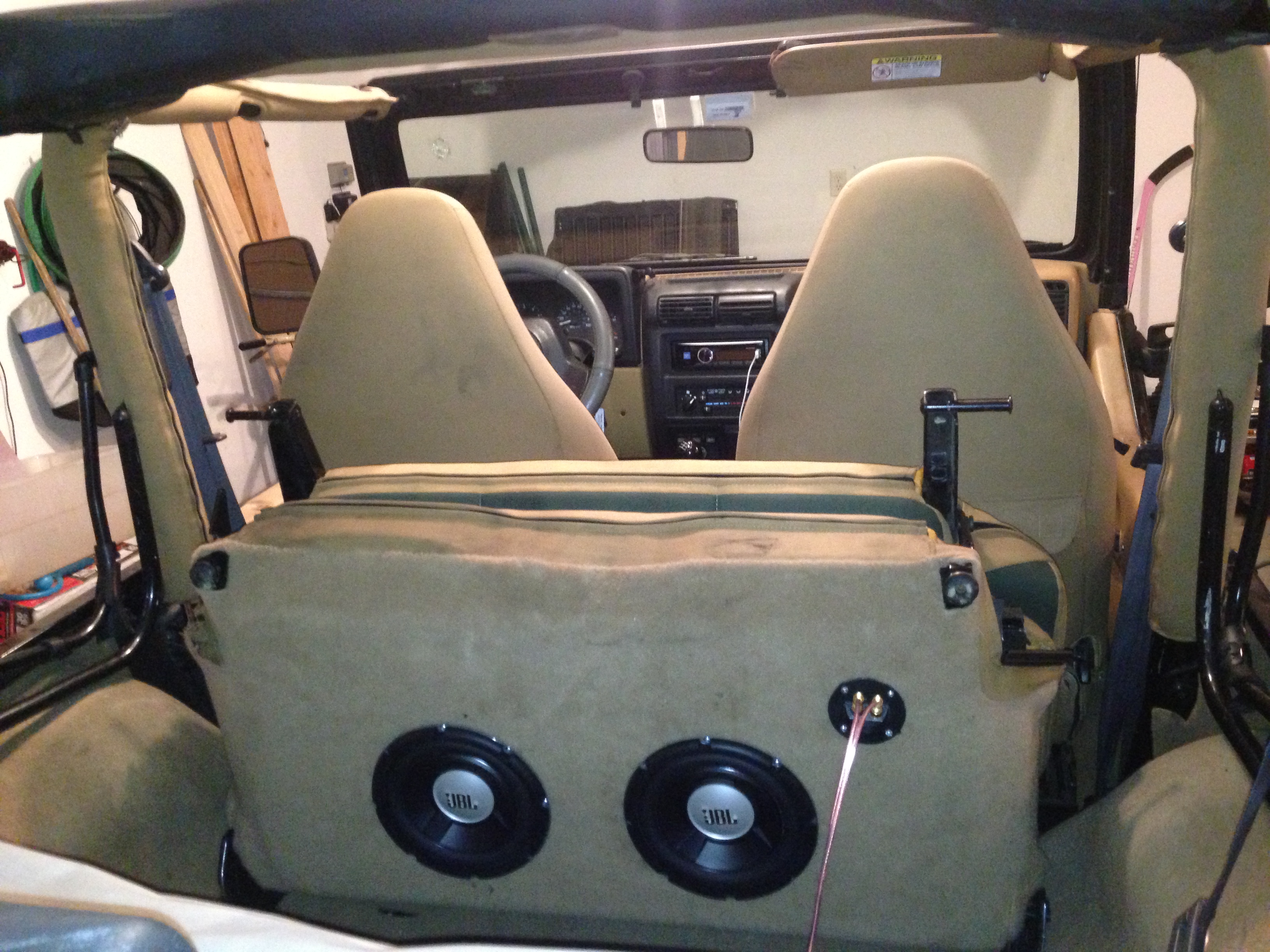

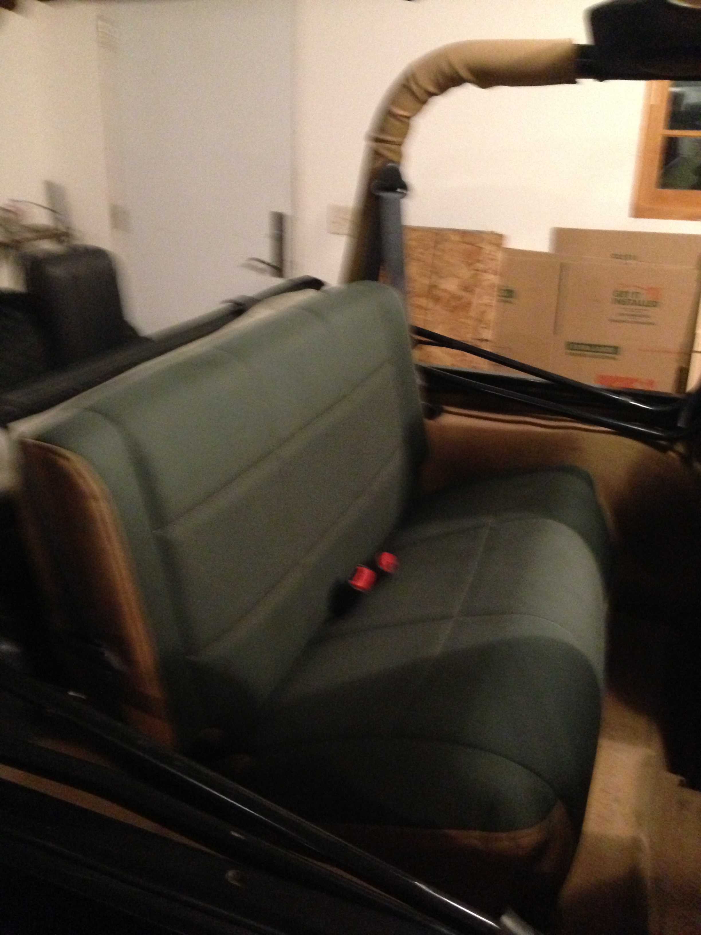

A lot of work, but came out great. Installed 2 8" subs, and 4 channel amp mounted in insta trunk.

With something like that you don't need to build the box. I am not sure if you can mount that in the seat or if it needs to be ventilated. It does not need any ventilation, i think you could just cut the crossbars, remove the foam, and set it in there.
I'd be nervous about mounting an amplifier inside of a block of foam. That amp needs airflow - you would likely burn up the amp, the foam, or both.
Now if you could mount the box such that the amp was exposed on the bottom you'd probably be OK.

I just finished this job with two ten inch subs and it worked great!! I couldn't have asked for better results!

I've read every post before asking the following question... I see you made 3 holes on bottom of box but only mounted one subwoofer. Are there two others that we cant see or is the 3 holes for a 3 sub demonstration but you were just doing 1 sub?
There was space for two 10" subs, but not three. Take a look at the first couple of posts again (there was a glitch for the forum software, and many photos were missing - it's fixed now). For me, one sub was great.
